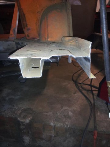

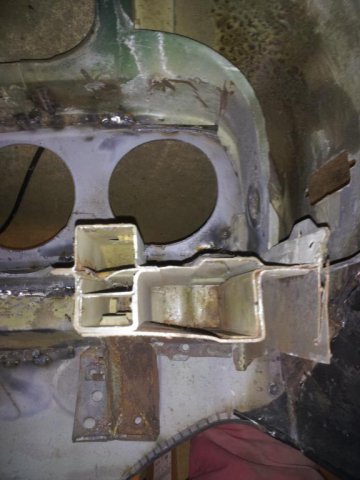

My plan for chassis/subframe fabrication...
eskwire88 replied to capriottikidd's topic in Fabrication / Welding
I just made flat floors, raised to the pinch welds along the rockers. A rotisserie is pretty much mandatory for fabbing the rear subframe. Can't imagine doing it any other way. Mine was scrap plywood and 2x6's. Strong enough to stand on, did two cars with it.- 19 replies
- frame rail
- subframe
(and 2 more)
Tagged with:
I used either .083 or .065. cant quite remember. Z32 is ridiculously wide, i can attest. I had to widen the car 8 inches and still had to use +45 offset wheels to tuck them under.- 19 replies
- frame rail
- subframe
(and 2 more)
Tagged with:
