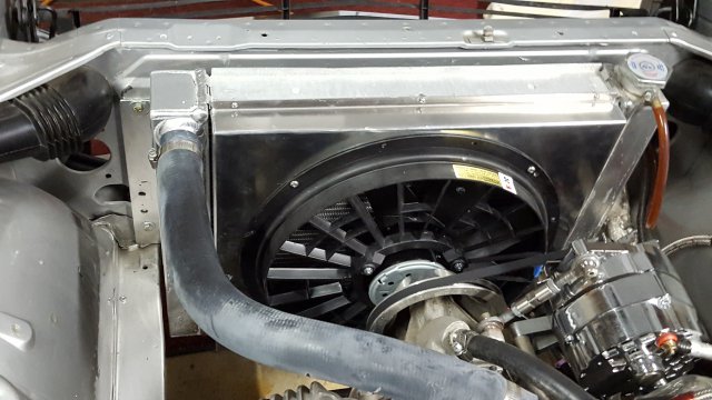

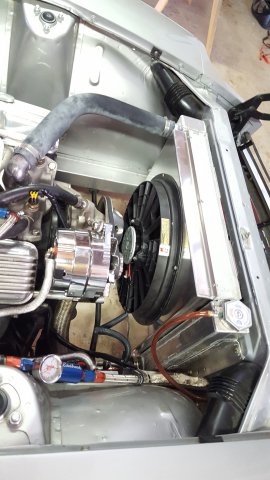

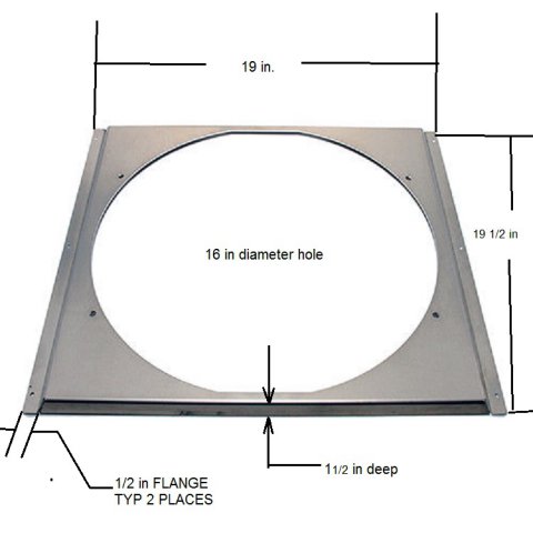

	94 -97 Volvo 850 electric fan Source: Summit Racing Dorman Electric Fans 620-883 $141.97 Painless Performance 30100 Electric 70 amp Fan Relay Kits p/n . $49 Comes with Maxi Fuse. Painless Performance p/n 30111 Fan Control, Thermostatic, 185 Degrees On/170 off (grounding) $47.9 Works perfect. Custom 19" H x 19.5" W x 1.5" Deep aluminum shroud by Mike Tolle Fabrication, Sacramento, Ca. Replaces failed Flex- a- lite Black Magic fan on Arizona Z Cars radiator. Note: All of the 30 amp Painless fan relay kits are wired to work with their grounding fan thermal switch. The Painless 70 amp relay kit is not. The Painless 70 amp relay kit is wired for the ignition switch or a fan switch to trigger the relay. I wired the relay to allow a grounding type Painless fan thermal switch to trigger the relay. When the thermal switch turns on, it grounds the relay which closes the relay and energizes the fan circuit. Not a problem if you are comfortable working with relays. You could do the same thing using a 70 amp Bosch relay and some wire. Painless website: http://www.painlessperformance.com/webcatalog/fanc
