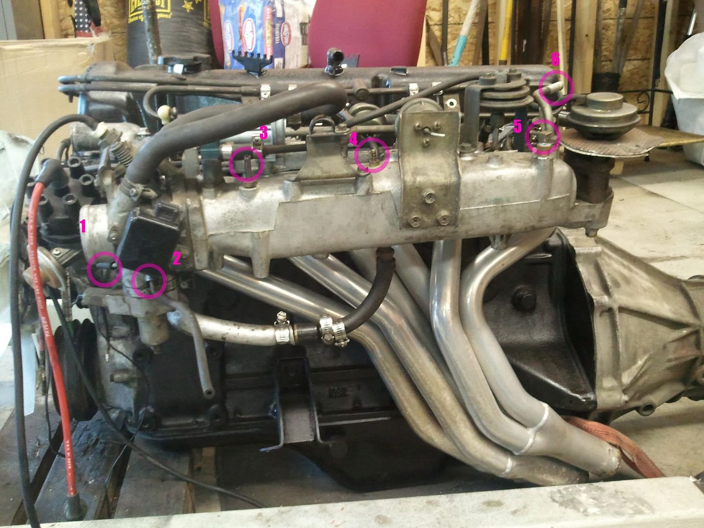

I posted this on another forum as well, this is my first time playing around with a piston engine, i normally rebuild rotarys. Anyways, im about to wrap this project up. I've been looking at the FSM and found the answer to most of the things i was looking for, but i'm still stuck on a few little ones. Could someone please identify what, and where the following goes to? And correct me if i was wrong in the identification.
Also, i do not have an AC. Can i plug all of the AC lines?
#1 is dizzy vacuum advance
#2 Looks like charcoal can vac signal line
#3 is Charcoal can, i won't have one of these on my car for a while, can it be blocked off?
#4 is this AC related? can this be blocked off?
#5 Unknown - runs back along the firewall to the other side of the engine bay, i don't know what this is for
#6 is brake booster
#7 Unknown - think its something for the AC
Yes you have them right. If you would like to see for your self here is the reference.
