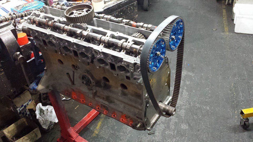

Jordon Posted April 27, 2014 Author Share Posted April 27, 2014 It has been a long time since I have been on here to post an update. I'm a bit slack in that regard :/A lot has happened over the last year, but I'm having some timing problems with my engine builder. Wanted the engine finished last year around October but he let me down. bunch of excuses blah blah. He is an awesome guy and knows what he's doing so I have been persevering.Anyway, On the engine side of things. It turns out that the pistons we had would be no good. After much umming and ahhing and a lucky coincidence there was a slight change of plans.I'm not sure If anyone has done it before but we are mating up an RB25 cylinder head on top of the L series block. (coincidentally my engine builder had an RB26 head laying around the shop and he had a look and test fitted it and it turns out that the cylinder bore and head bolts all line up. Not all oil passages or water jackets do but some modifications have been made to get those to either line up or grab an external oil feed for it.) For pistons we are now going with some dished supra pistons and keeping the crank and rods I already had.So now the engine will only displace 3.3L but still better than nothing. The RB25 head fitted to the block with the adjustable cam gears fitted. To make all the timing work out I got an RB25 timing belt crank pulley, which my engine builder has bored out to fit on the L28 crank. At the moment he is in the process of sorting out the tensioner for the timing belt and sorting out the oil pump mount (Dry sump pump going where the old air conditioner compressor mounts,)On other areas I the front end all together with new polyurethane bushes and the assorted parts from T3. With the wheels on it looks great (unfortunately haven't been able to get any photos lately on account of the car being back home while I've been away.)Next I will be moving the car to my garage to pull apart the rear end and get some rear coilovers sorted, put a full spool in the diff and re-bush the rear sub-frame/suspension arms. 1 Quote Link to comment Share on other sites More sharing options...

TonyB Posted May 22, 2014 Share Posted May 22, 2014 This is interesting. Lets get more pics of the engine Quote Link to comment Share on other sites More sharing options...
69sroadster Posted August 15, 2014 Share Posted August 15, 2014 I'd really like to see the RB head on the L28 block working. Seems like it would be a lot cheaper than the Tomei cross flow head, if you could even find one. Good luck mate! Quote Link to comment Share on other sites More sharing options...
