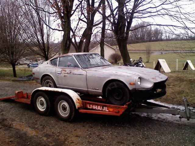

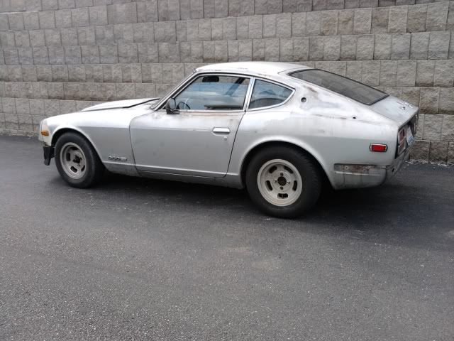

Bougth it from Tennessee. It barely ran, and had no brakes.

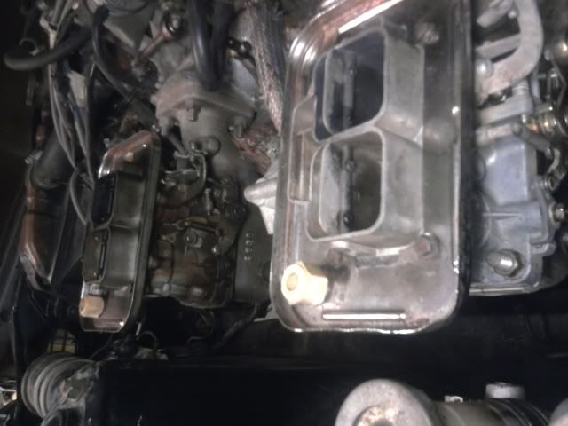

Rebuilt the Weber DGV's and replaced the rear brake lines to make it street worthy.
Replaced tires so I could run all 4 slotted mags. Removed the fuel tank so I could remove the rear bumper supports. Cut a coil off of the rear springs for a slightly better stance.

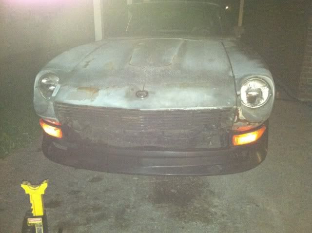

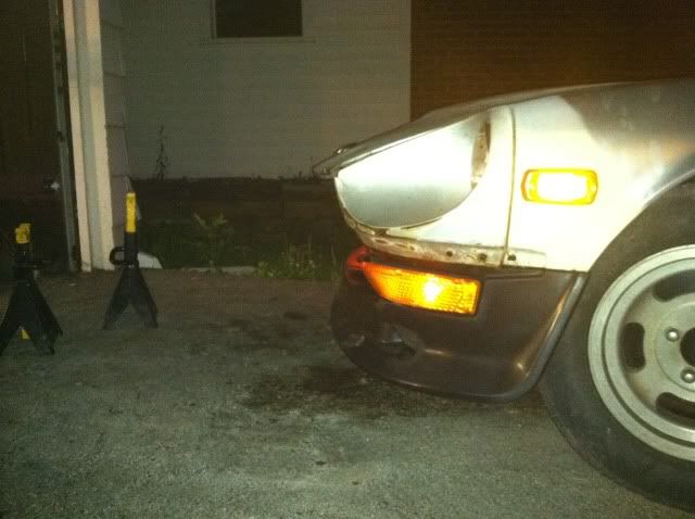

Picked up front turn signals and a MSA front spoiler so I could replace the 280Z spoiler that came on it (now for sale, PM me).

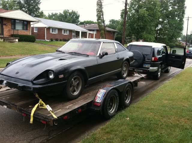

Bought a 83 280ZX Turbo 5 speed as a donor car. So far I'm in the process of getting it running with Z31 ECU/MAF before I pull all my parts...

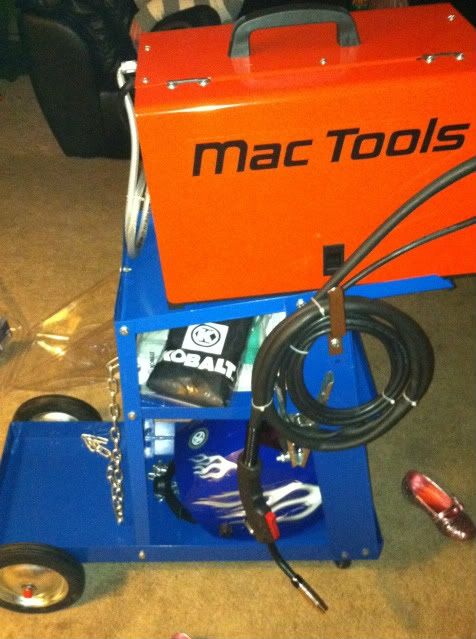

My amazing GF got me a brand new 130 amp MIG welder for Christmas! That thing is going to get a workout as soon as I get a tank of Argon.

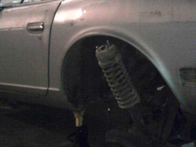

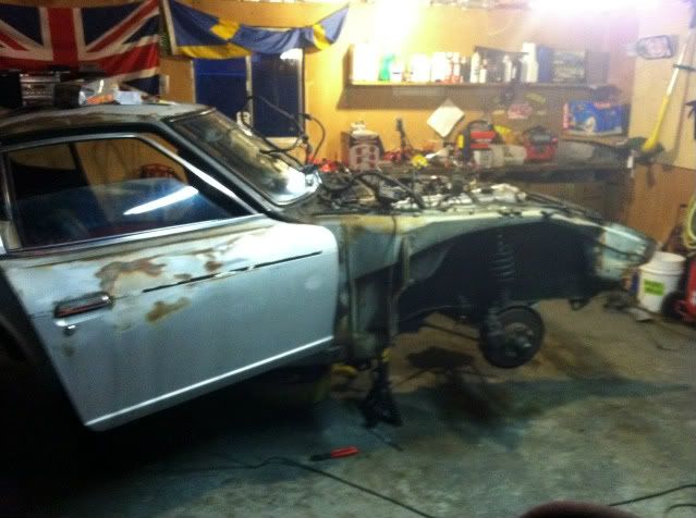

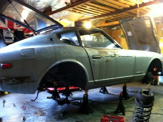

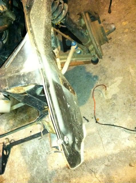

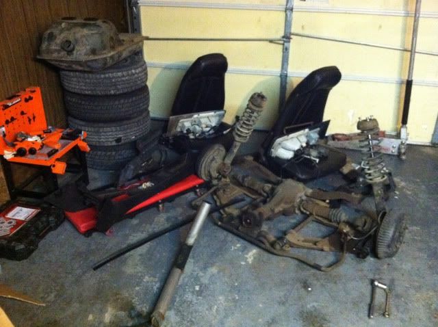

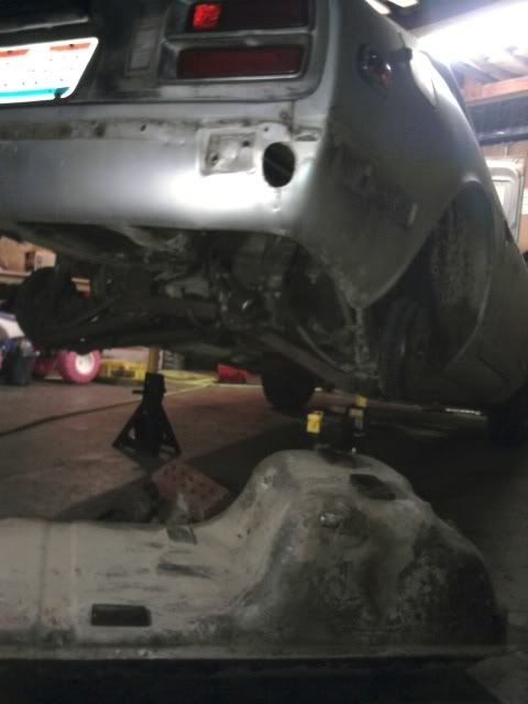

With help from my uncle, we dropped the exhaust, and then the driveshaft. After that, we dropped the fuel tank, followed by the rear suspension/brakes/diff as an assembly. I also took out the rear tail lights and all side markers.

Said welder...

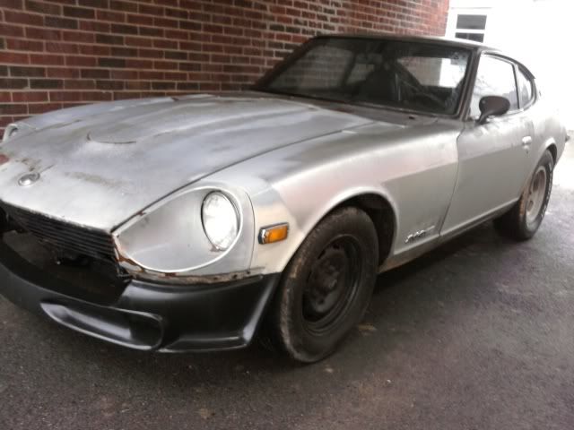

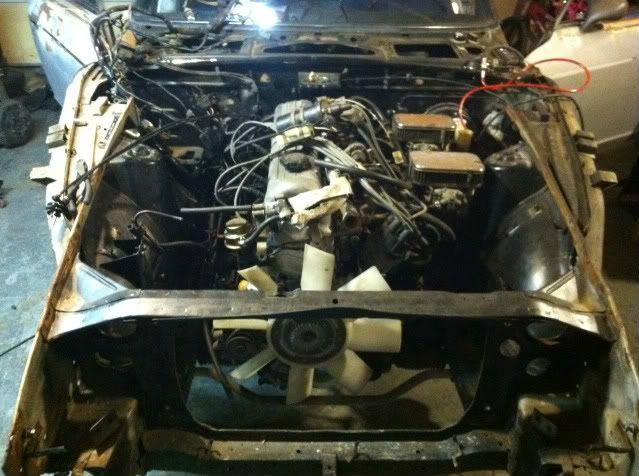

Pulled off the front fenders, headlights and buckets, grille, front air dam, hood, hood hinge assembly, and cowl panel.

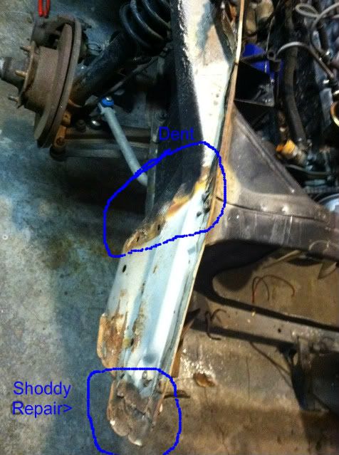

Found my first bit of body damage. The passengers side headlight bucket was fiberglass and the driver's was metal. I knew it was hit in the RF corner but wasn't sure how hard. Here is the damage. Dented slightly and shoddy repair panel toward front. No biggie.
Here is the driver's side for comparison...
We got the engine and trans ready to be pulled when I get the engine hoist to my garage.

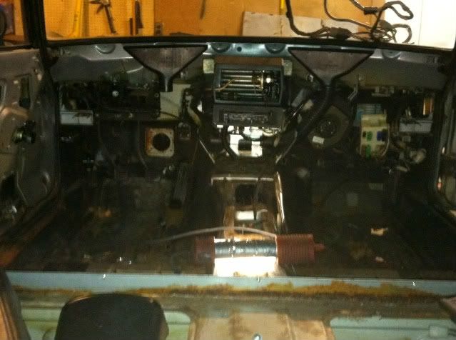

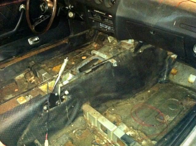

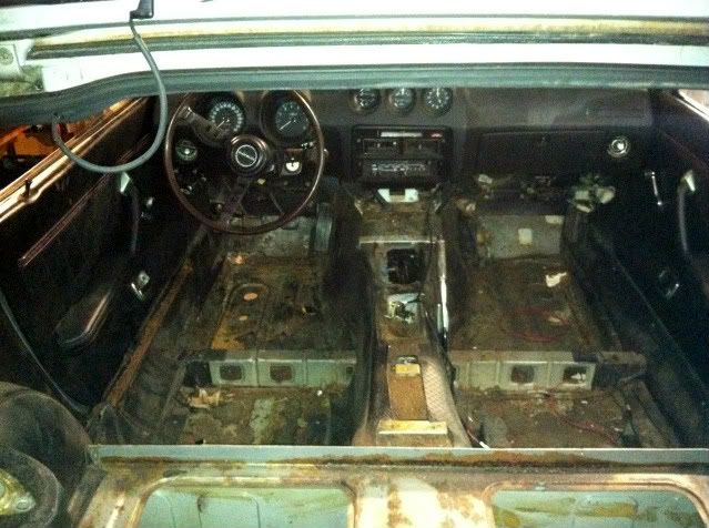

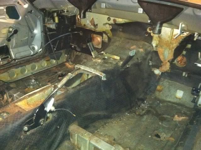

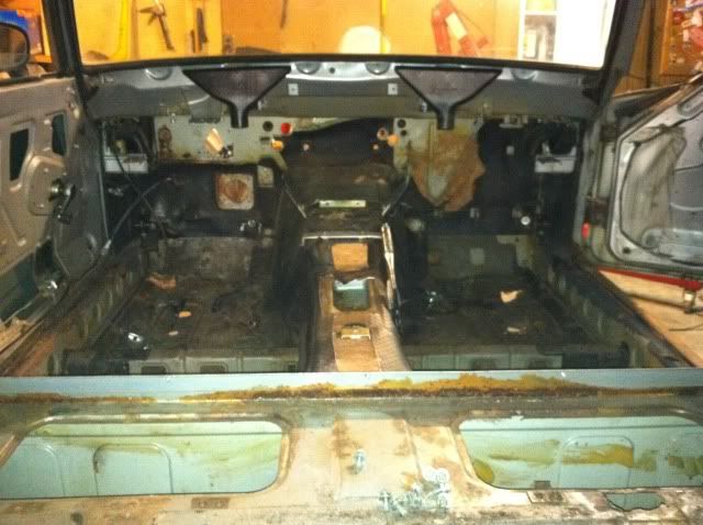

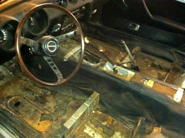

After that we decided to tackle the dash. Not nearly as bad as I was expecting. We also pulled the door panels.

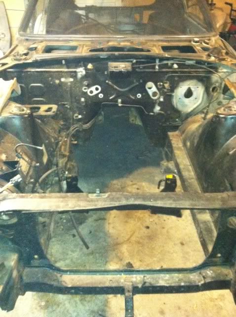

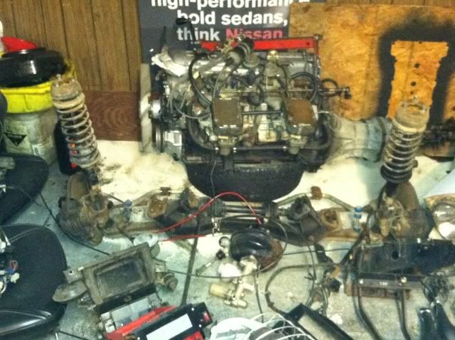

Made some more progress over the weekend. After getting my welding tank I had a couple friends come over with an engine hoist. Everything went very smoothly.
Since we got the engine out so quick, we went ahead and pulled the wiring harness, the brake master/booster, the clutch master, all the pedal assemblies and the heater controls, the evaporator box, and the heater core.
All I really have left is the brake and fuel lines, the doors, the hatch and the glass. Can't wait to start metal working! After I get it stripped completely I'll have to organize my garage and find places for all the parts that I've removed.
