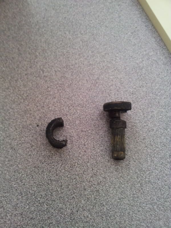

I took apart my door today to rebuild the hinge. After some work my door finally opens and closes nicely, but I'm having a heck of a time trying to get the door lined up. Anyone have any tips on how to get it? I stupidly didn't make marks as to where the hinge attached and that leaves me in this situation. Hopefully there is some method other than just trial and error.
Also this is what my roller pin and roller bearing looked like upon removal.
