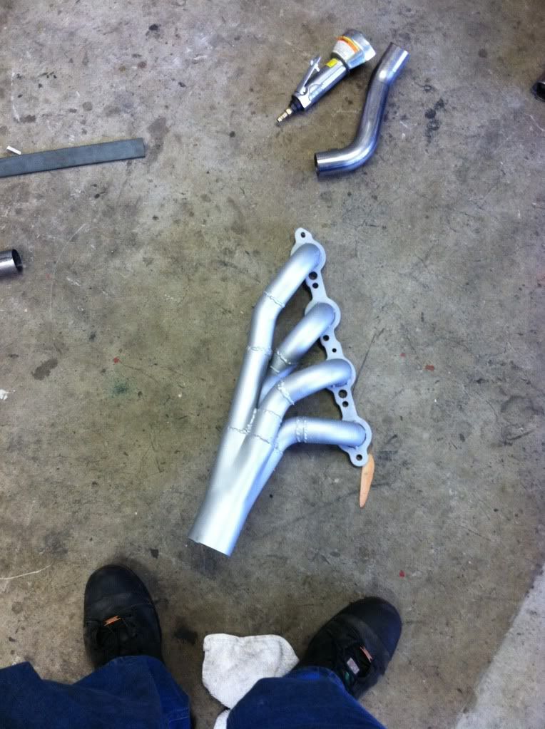

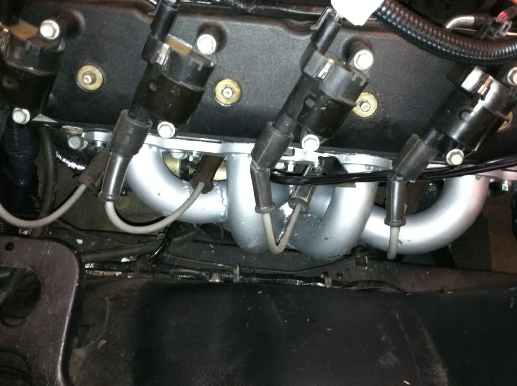

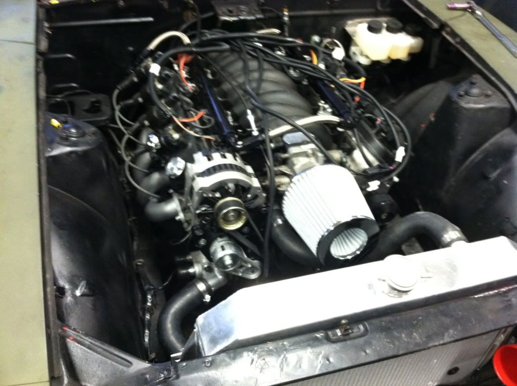

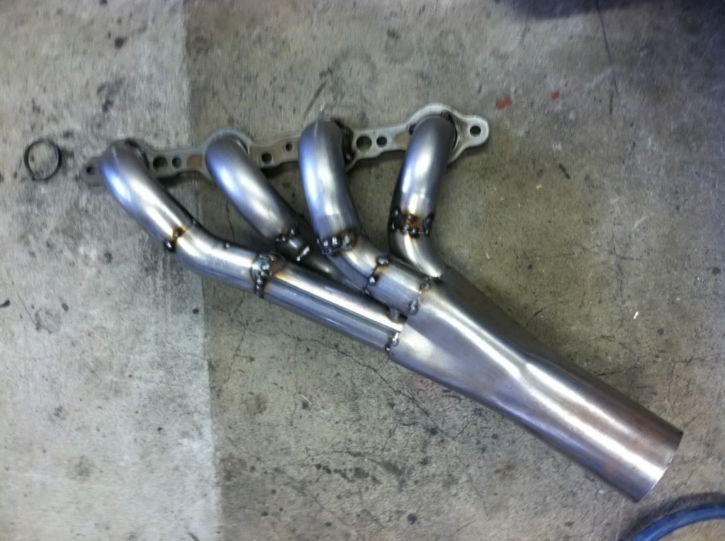

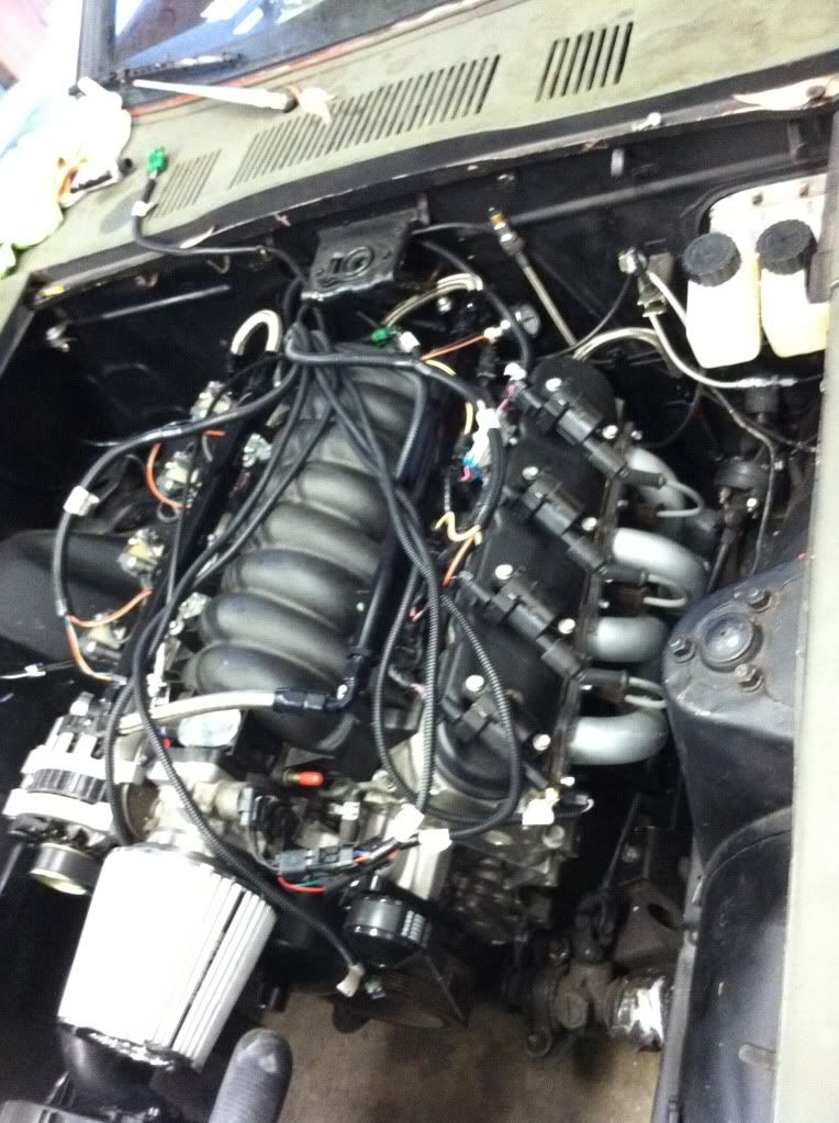

Fuzzydicerule Posted June 15, 2012 Author Share Posted June 15, 2012 aight, do you still have my number, text me first. anywho, i had a fairly productive day. My headers are now built and installed, and my driveshaft is in, and the car is no longer on jack stands! I didnt take any pics when i was building the passenger side, as my buddy was helping me, and we got **** done very quickly, the other side was alot more brainstorming on my part, so i took the time to snap a few. The passenger side is a block hugger, exiting near straight down in front of the starter like you would expect, and the drivers is a normal shorty with lots of weird kinks to avoid ****, like you would expect. Drivers side mid fabrication, this was right after i got all the tubes cut and test fit, just before i took it apart to finish weld it. after welding and a coat of paint, i then realized i forgot the o2 bung, so i welded that in after this pic was taken passenger side front, so you can see the collector From the top my engine with its rats nest, that will be consolodated a bit to make it look a bit nicer once i get the car running. first time my cars been on the ground in a month, it sits a bit better with the LS1 and T56 in there too... Thats it for today, thanks guys Quote Link to comment Share on other sites More sharing options...
RebekahsZ Posted June 15, 2012 Share Posted June 15, 2012 Amazing! I can't believe how fast you are getting it done. What radiator and what hoses are you using? Quote Link to comment Share on other sites More sharing options...
The Infidel Posted June 15, 2012 Share Posted June 15, 2012 (edited) You gotta do something about that split loom stuff.... Lol. http://www.cabletiesandmore.com/nylon-mono-braided-sleeving.php Edited June 15, 2012 by The Infidel Quote Link to comment Share on other sites More sharing options...
Fuzzydicerule Posted June 15, 2012 Author Share Posted June 15, 2012 I bought an eBay special 3 row aluminum radiator with twin electric fans and johns hoses. The upper hose from John fit great, the lower fit like **** so I made a wire shape and went shopping at my old sore (O'reillys) and found one thy had the right have(in the middle) an cut te ends off and it fits like a glove, As far as getting **** done its going way slower than if like tbh Infidel. Keep in mind that literally just tossed the wiring on te motor, I haven't had a chance to do anything with it yet Quote Link to comment Share on other sites More sharing options...

Fuzzydicerule Posted June 19, 2012 Author Share Posted June 19, 2012 SHE LIVES! Sadly, she does not drive =( Quick overview of my day. I spent it finishing all the small wiring bits for the ECU and whatnot, once i was done with that, we primed the fuel pump only to find out those STUPID F-ING Ferrule Fuel line ends decided to leak, as 3 of the 4 fittings had the ferrule get cocked in the line, and therefore, not seal. So i took a page from the ghetto handbook and just hose clamped the 3 hoses over the flares on the tubing, and it all seals just fine now... After setting up the base tune on the ez-EFI, on push of the button and she fired right up... it was pretty damn cool, and it warmed up and stayed right at 195 degrees.. Annoyingly, it then promptly proceeded to not want to move... It seems i have a dilemma... Now for question time... I am using a 7/10 Master cylinder on my pedal box. I am 90% sure im using the full travel of the MC, but even on the floor, the clutch does not disengage. Does anybody know what the stock MC size was on the LS1 cars? I dont want to have to get a new cylinder, but thats looking like a possibility., unfortunately, the other possibilities (improper slave adjustment, or a leaking line at the slave) require the removal of the trans... The other option was, maybe i missed an adjustment on the slave cylinder? i have bled the thing multiple times and it feels fairly soft, i was just hoping that was the feel of the clutch... Quote Link to comment Share on other sites More sharing options...
