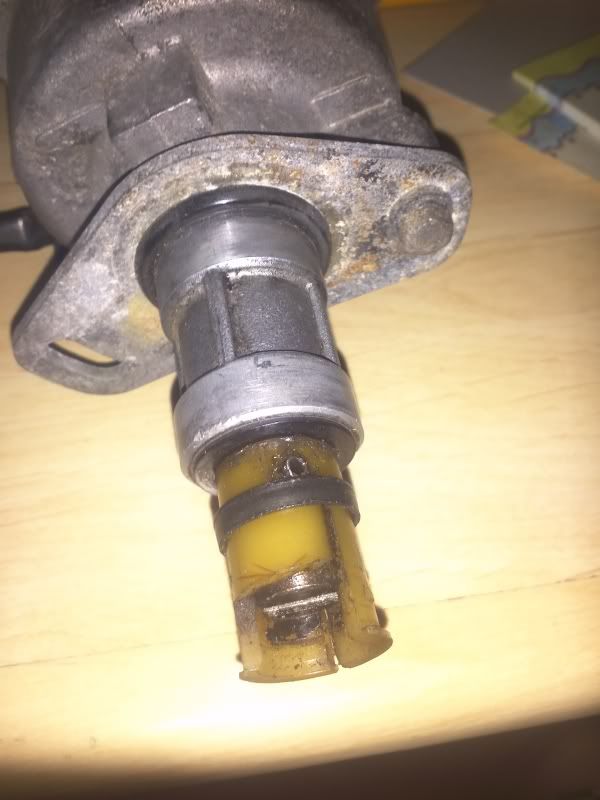

six2eight Posted June 8, 2012 Share Posted June 8, 2012 Got this dizzy from a buddy, there is a plastic piece on the end of the dizzy shaft that has a broken bit, just wondering if this plastic piece can come off and be replaced with another one. Quote Link to comment Share on other sites More sharing options...
Leon Posted June 8, 2012 Share Posted June 8, 2012 (edited) That's the coupling and is held in by a pin. You have to knock out the pin in order to remove it. New ones are available from Nissan, probably in the updated metal style (the plastic ones were clearly not as durable). Looks like the part number is 22119-W0400. I broke mine while rebuilding my ZX dizzy. Edited June 8, 2012 by Leon Quote Link to comment Share on other sites More sharing options...
