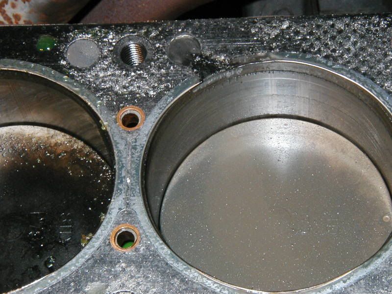

I was not proud of street racing and i was punished for it I blew the head gasket! Found the time to take off the head and see the wound I made to my baby ! To this day I never drove it again and im still mad at myself for it.

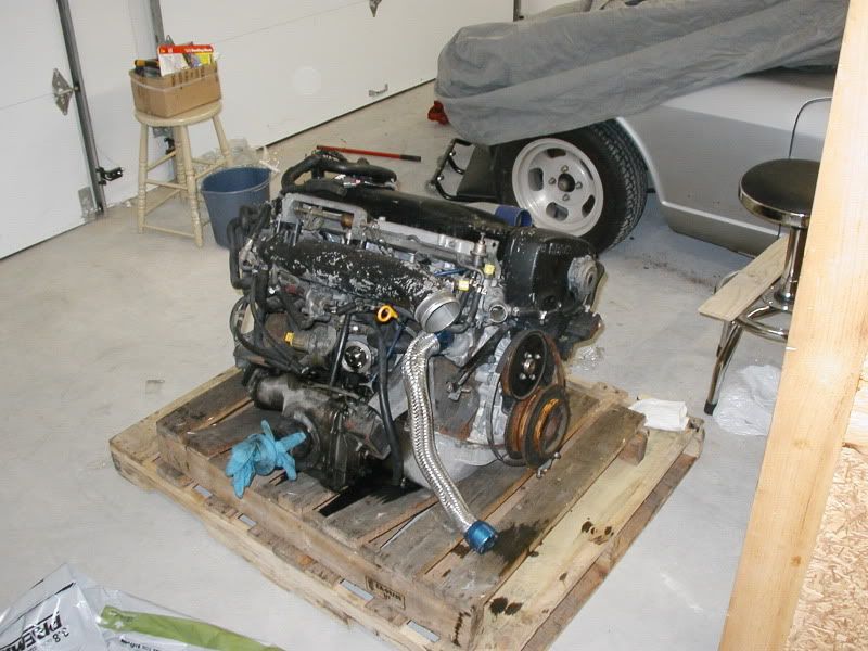

I came to the time where i could have the time to work on the Z again. So i made the decision to ditch the L28 and go RB26 so i hitted the interwebs to find a good engine I didnt want to have a afghan RB form a importer in Montreal so i tried to find one from a running zed. I found a guy in BC who wanted the body and all the suspension and brakes and all but had his own engine. It was match made in heaven so after a month I got the motor home !
made in heaven i SAID !
The engine was suppose to have this ! but didnt have a couple of the advertised bits I worked it out with the seller and this is what it had in reality

What I got for realz
R34 N1 Nur turbos
Unknown cams probly stock
Tomie gears
Tomei Gasket is still a mystery if its their or not
N1 oil pump
N1 water pump
Coil pack and harness was brand new in a bag !
Nismo FPR
534cc injectors
HKS inlet pipes

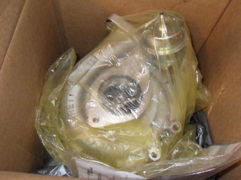

Anyway I had to strip some of it down for inspectin and prep for the swap. I found a nasty problem right away the first weekend. The front turbo inlet had a ... lets say special pitch to its impeller
It was "modified" by a rag sucked in I was told. A freind told me he saw that once where he used to work. Garage takes off I/C puts a rage in to prevent stuff from going in and then forgets it puts everything back on then boom ! Had a long talk with the seller he couldnt know if hes not lying and he was honest with everything else and always up front so i had no reason to doubt him when he told me he couldnt have know he drove the car 1 bloc at low speed and it didnt show when he did the compression test for me. So we splitted the cost half.

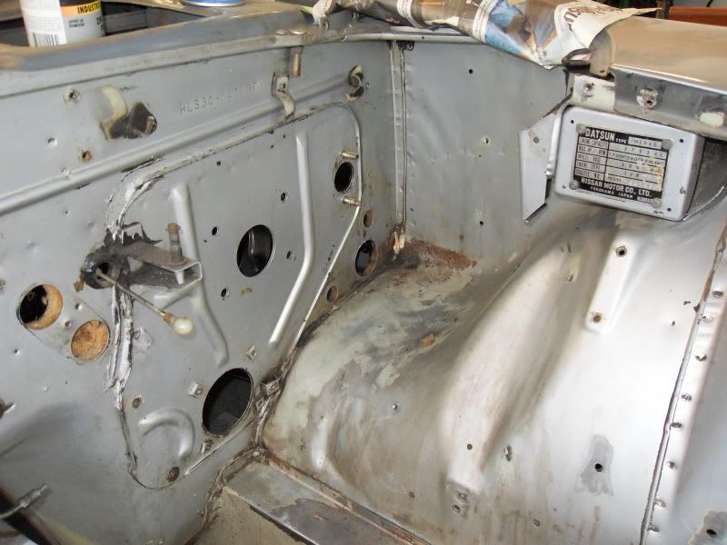

While i waited for the turbo to arrive i decided to dismantle the zed for rust inspection sound deadner removal and prep for L28 removal.

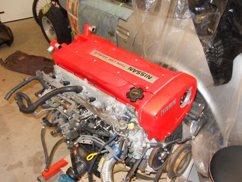

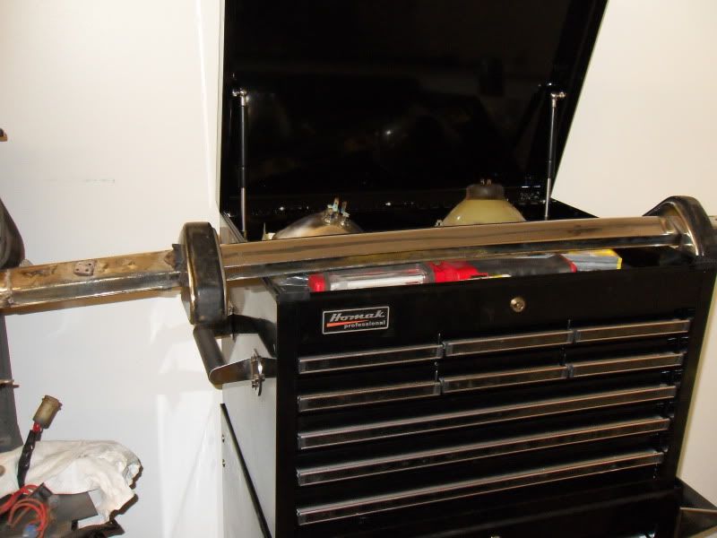

Then I did a couple rust repair but i kept on finding more and more and it made take a break form the search before i could find the mother load i was scared to find. I received my Mc Kinney mounts and Pat1 made me one of his amazing piece of art ! I paint the valve covers got bumpers and did a mild polish of my turbo manifolds.
A peice of heaven came in the mail !
the bumpers
the painted VC
McK's Mounts

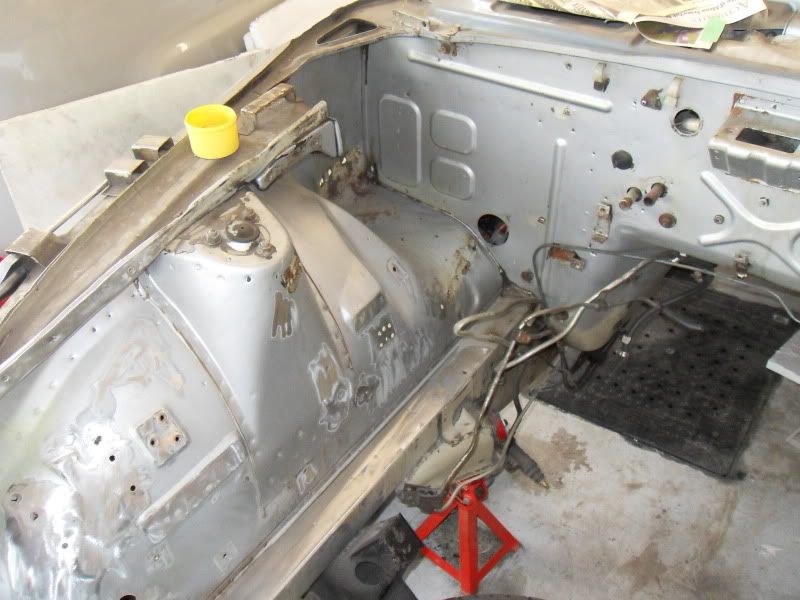

I cleaned up the engine bay to removed all the brackets and the battery tray
The polishing i did

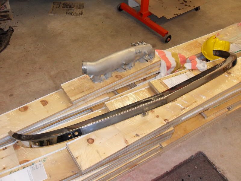

Then i polished my intake plenum What a PITA job it was ! but love the finished results

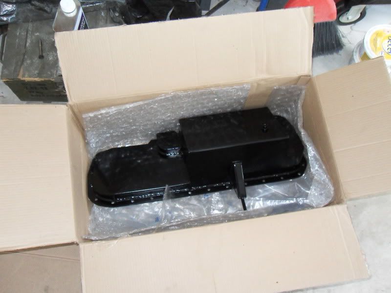

I installed the peice of heaven on the RB to make it more holy !

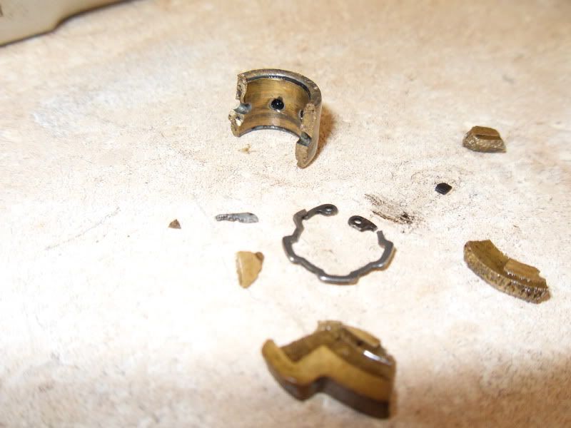

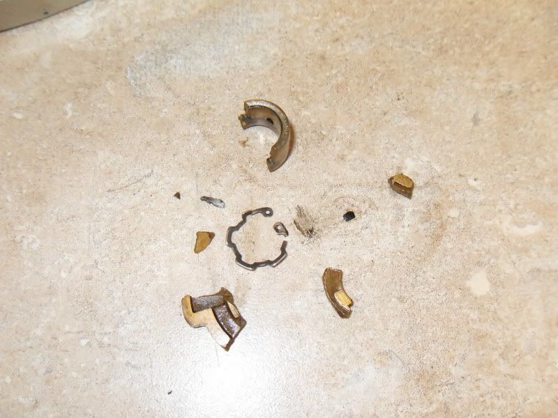

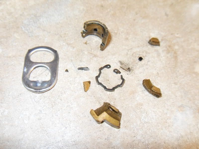

Found some nasty peices of metal in the old pan probably somethinged happend the this engine before because the seller told me it had a rebuild done and a bottom parts refresh. Their are the peices found.
I dont like that at all but hey ill keep going for now on closer inpsection didnt inside when i was installing the pan everything was mint up their.
Turbo arrived in the mail !

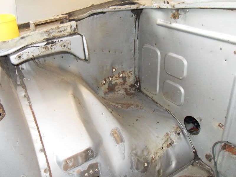

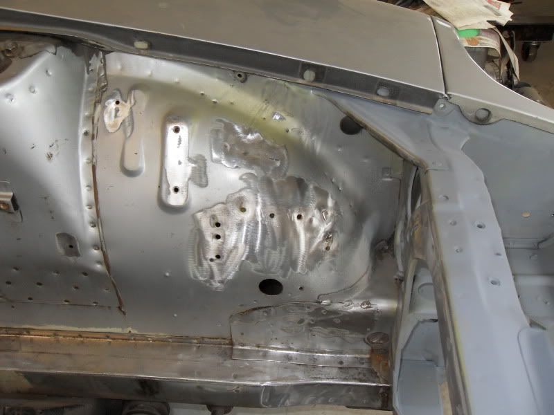

Then I did more body repairs and fell into the bottomless pit of the while your at it !
I decided after founding yet again more rust to call in the special forces ! I brought the car to a sandblast shop in my village. So i stripped her naked in a hurry every bolts and nuts ! here she is in all her naked glory ready to leave for the special forces head quaters Oorah !
When she was gone i cleaned up the place it was a cluster **** of dust ,debris and parts. went to bbot camp to take pictures of the woopin.
Quite a woopin it was ! then i had them fix the misc. holes left and the old guy their loved the zed so much he didnt some extra body work for free !!!!
