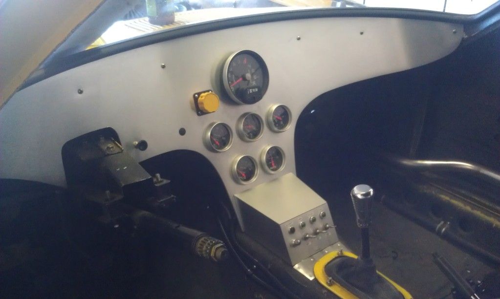

We chose to mount the iDash between the seats to keep it away from the heat/dust/dirt. I taped a few of the unused connections so that they wouldn't get filled with dust/dirt if we made an off track excursion.
Here's a picture of our dash layout with the autometer gauges that we are still going to use.

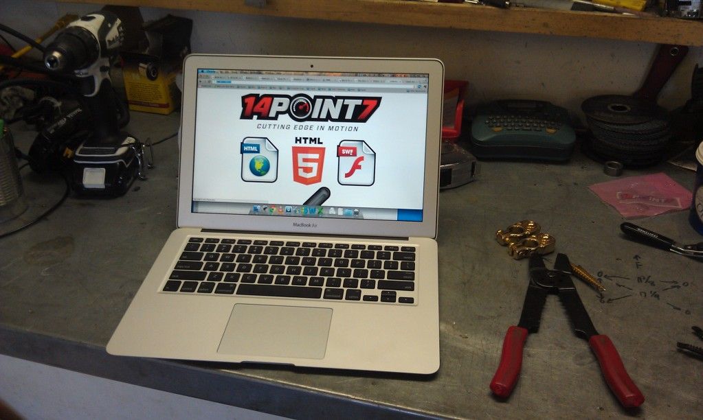

iDash interface on my Mac during testing....

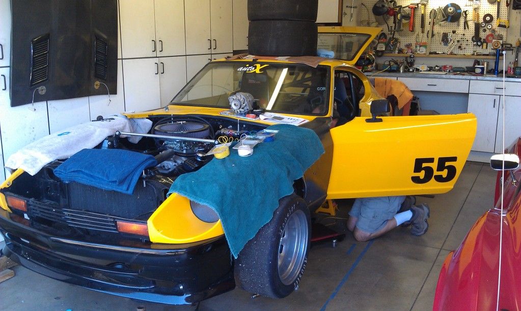

Overall picture of the car during this and other mods recently, after I went off track an put a hole in the oil pan. :blink:

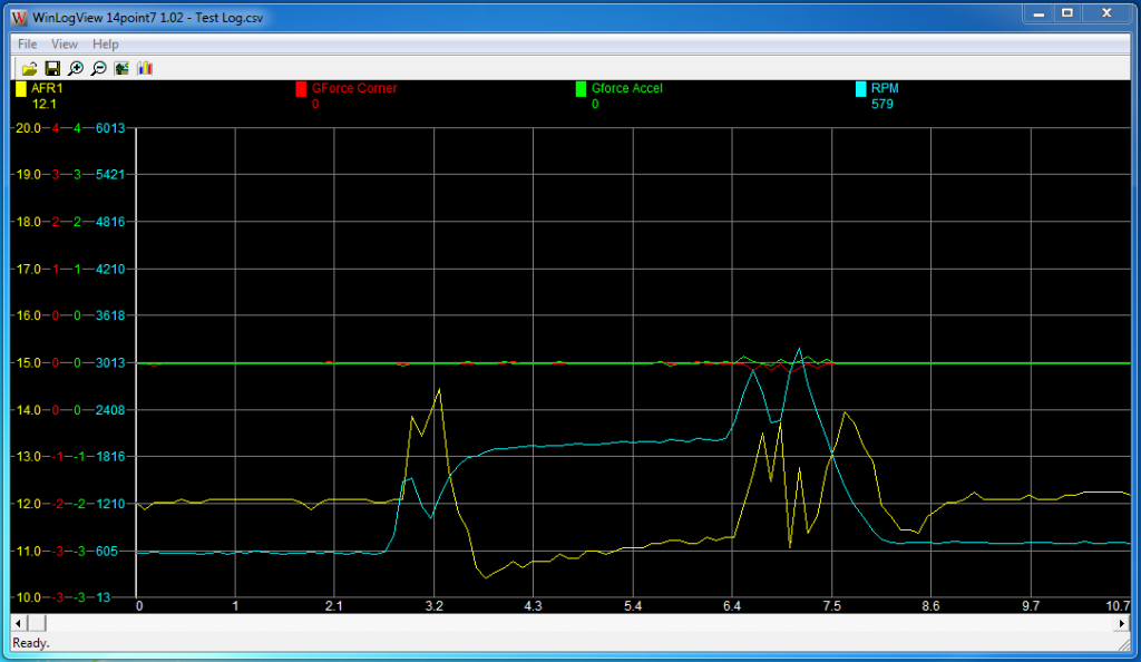

Just got the car running again after replacing the oil pan and adding the iDash. This is the first log out our iDash. It clearly shows our mixture ratio is too rich for our altitude at idle which is OK because we tuned our car for near sea-level conditions in Medford, OR. There are several other tuning nuances which we discovered with the wideband O2 sensor, when we get back down there next weekend we'll see how we accurately tuned the car without the wideband O2 sensor. :)
Super excited to see some more results from this logger, as well as add the additional channels for oil pressure, egt, map, accelerometers and stuff.
