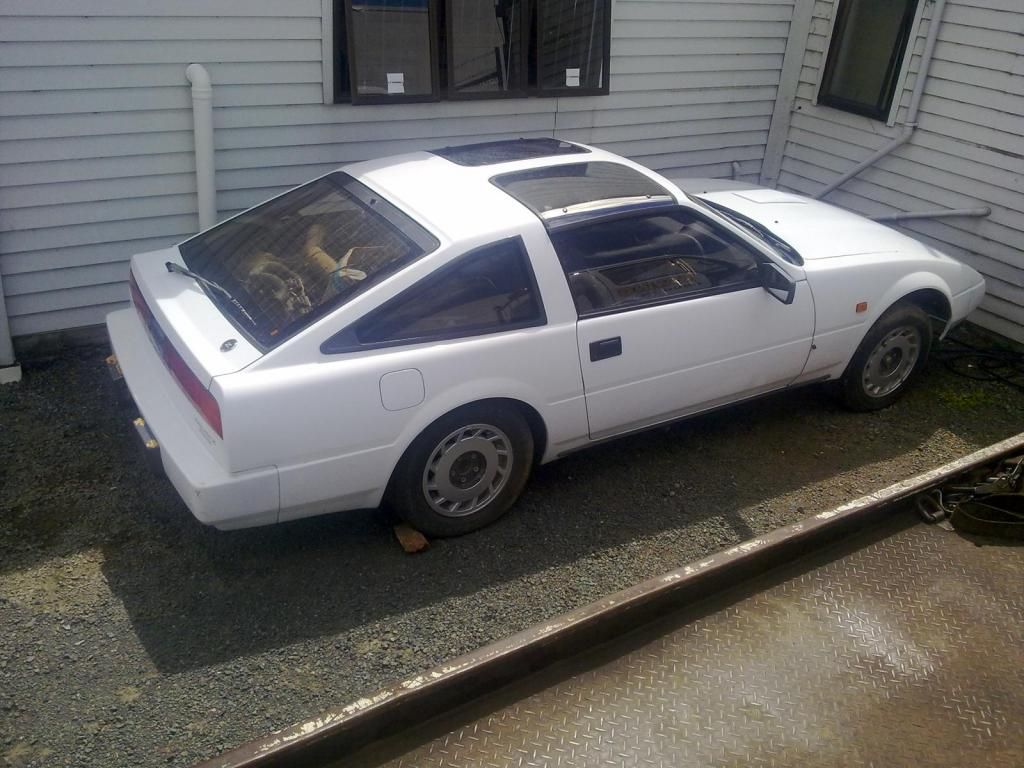

badhabitZ Posted November 19, 2012 Author Share Posted November 19, 2012 hi djz, no not one on trademe, saw that though. i've done a bit of research and i think i'll buy it. I don't want to go nuts on the engine side, i love torquey engines so a mild rb30det will do nicely plus with having all those bolt on bits like mounts etc i'll speed up a few things for me. Thanks for the advise with the sump i'll perhaps add some baffles to it later but i'm not wanting to do any track stuff, just street. Hoping to use the loom and computer from the ZR too, probably have to do chip or something i expect? and the rest of the shell i'll part out to the Z31 guys, i'm sure there are a few bits i can sell to recoup costs. brakes - i've got 4 pots for the front all ready but like the idea of 5 stud, maybe running some 370Z rims? and the rear may as well follow. Selling the stock 240z bits should help with costs again. pic of the car. Quote Link to comment Share on other sites More sharing options...
