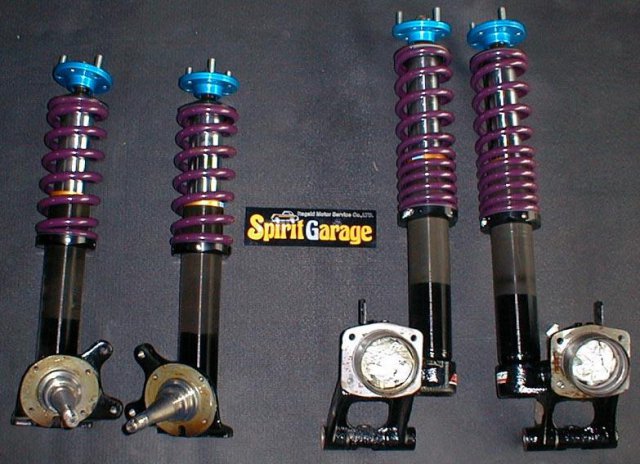

Tuner Galleria Posted January 8, 2013 Author Share Posted January 8, 2013 (edited) Photo of the Cusco Pillow Ball Mounts used on a coilover setup from Japan. Edited January 8, 2013 by Tuner Galleria Quote Link to comment Share on other sites More sharing options...
surfer.tech Posted January 10, 2013 Share Posted January 10, 2013 ^ that's the aragosta coilover for the S30. Quote Link to comment Share on other sites More sharing options...
