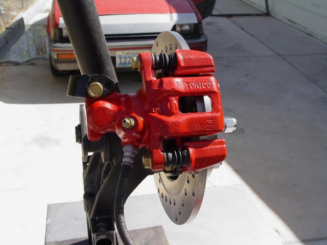

BitchinZ Posted March 7, 2013 Share Posted March 7, 2013 (edited) Can someone please identify what brake kit this is? I have the Silvermine motors 4 piston big brake kit for the front, would this be a good match for it on the rear or should I keep the stock drums? Thanks http://lasvegas.craigslist.org/pts/3527521981.html Edited March 7, 2013 by BitchinZ Quote Link to comment Share on other sites More sharing options...
RebekahsZ Posted March 7, 2013 Share Posted March 7, 2013 That is a maxima caliper kit sold by Sean Schlapi. It has a great emergency brake, but the maxima caliper doesn't clamp any better (maybe worse) than a stock drum system. But, this system does work with 15" wheels. I would do the Silvermine rear kit, but be prepared to need larger wheels, maybe even 17". You'll also need to carrry a brick with you for an e-brake. But the Silvermine system gets great reviews. Quote Link to comment Share on other sites More sharing options...
