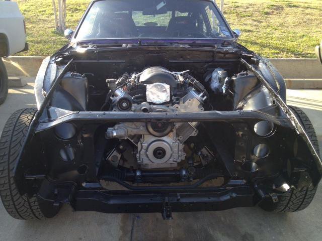

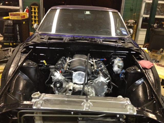

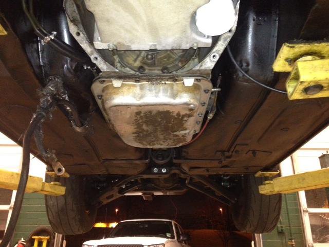

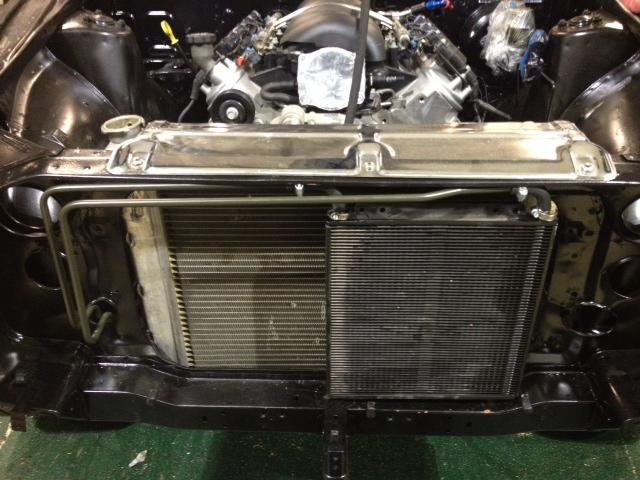

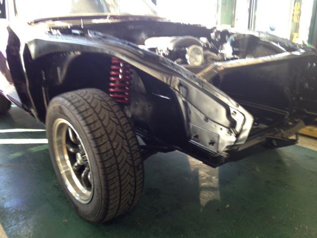

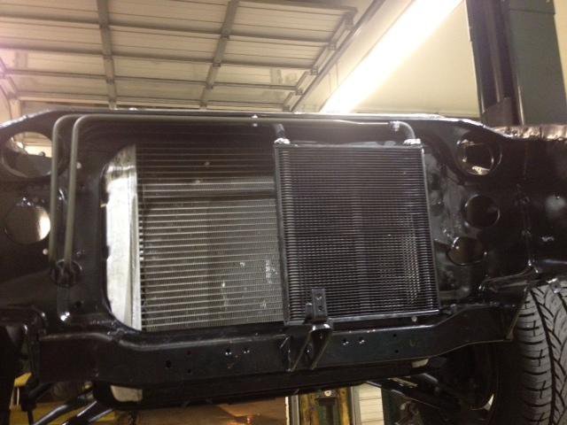

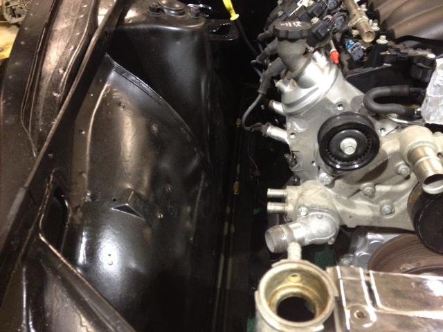

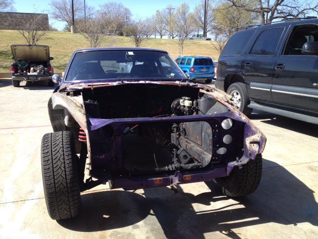

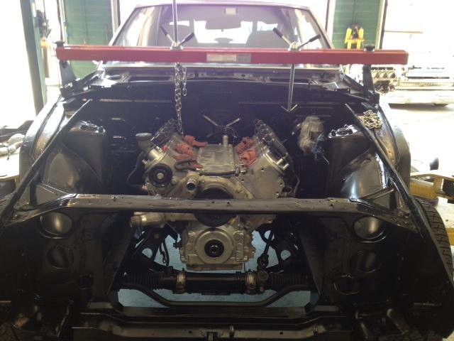

Well it is official we got it in this weekend!  A little messaging but if anyone doubts it, it ain't near as hard as I figured going into the swap. Will post pictures of the purple turd tomorrow. Just need to figure long tube headers out, drive shaft shortened again, radiator lines and harness. Got the fuel system in using a Bosche 044 pump, Wix Corvette regulator, filter and return. Made our own hard lines trans cooler using 3/8 hard brake line and my friend who can bend anything...friends are a good thing...LOL

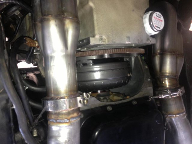

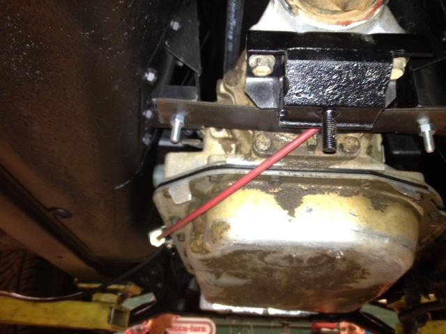

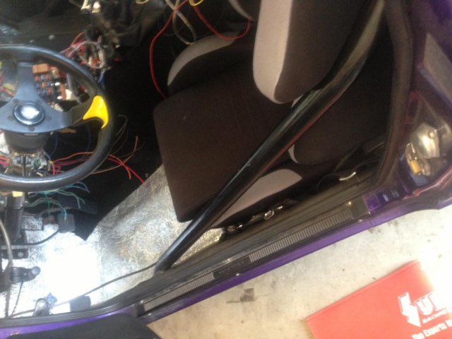

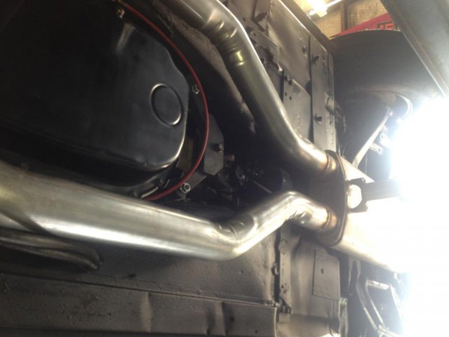

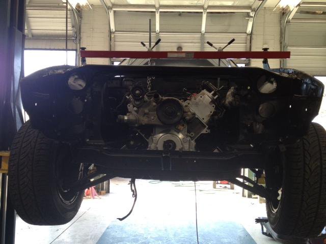

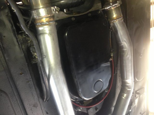

I know Jake, he works with a good friend of mine Daniel Muse at CBA in Corinth.  The car goes in Saturday for the trans mount, header message and exhaust system. I have the 3rd thru the 8th off so I plan on finishing the wiring and getting the body back together, dash should be in as well. Time to get serious and rock and roll!
