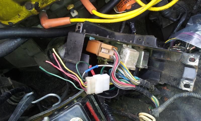

rickyellow zee Posted April 5, 2013 Share Posted April 5, 2013 (edited) Im trying to sort out some issues with my 280z. First off Im not getting power to my air regulator so I traced the green wire from the air regulator which is supposed to go to the fuel pump relay (I think?) and I see this. Cut harness. Anyone know where these wires are supposed to go? Looks like there is a relay in the black box with nothing attached. Any ideas as to what relay and where these wires were supposed to go? I think the previous owner wired in a new fuel pump and did it his own way. lol Thanks Edited April 5, 2013 by rickyellow zee Quote Link to comment Share on other sites More sharing options...

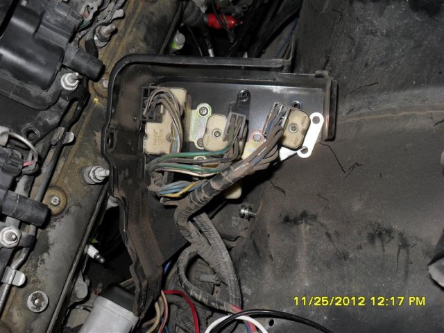

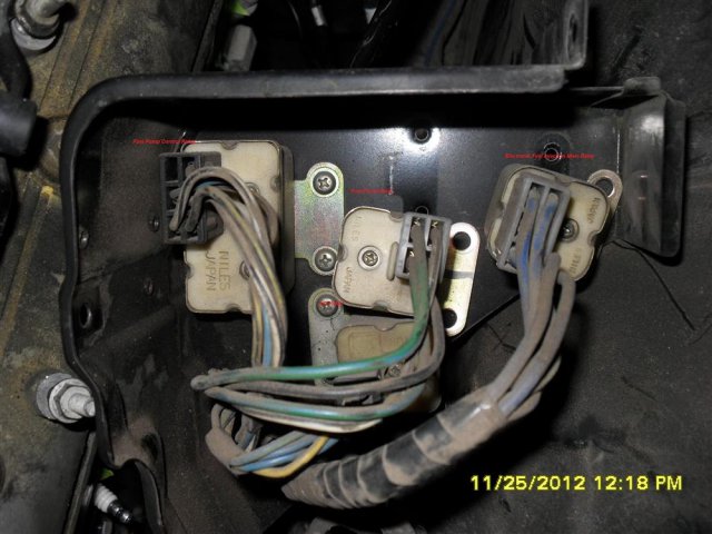

Domzs Posted April 5, 2013 Share Posted April 5, 2013 (edited) Here's mine . Don't see any connector and FSM doesn't show any either . It looks like fuel pump control relay connector but wires color don't match FSM . It's hard to see ( your photo ) , looks like there's a relay without a connector . Edited April 5, 2013 by Domzs Quote Link to comment Share on other sites More sharing options...
rickyellow zee Posted April 6, 2013 Author Share Posted April 6, 2013 The mystery relay is the air conditioning relay and the plug looks like something that was added somewhere along the line. Quote Link to comment Share on other sites More sharing options...
Domzs Posted April 6, 2013 Share Posted April 6, 2013 Looks that way . Quote Link to comment Share on other sites More sharing options...
