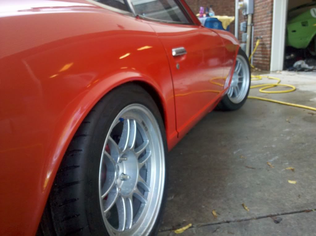

zack_280 Posted May 5, 2013 Share Posted May 5, 2013 RebakahsZ, No problem, but I usually don't go out of my way to autocross in Nashville. If you are ever in the Chattanooga area, let me know. Here are a couple of pics. Quote Link to comment Share on other sites More sharing options...
zack_280 Posted May 5, 2013 Share Posted May 5, 2013 PS. These pics may have been before the alignment, but it looks basically the same as this. Also, we have a Chattanooga Region SCCA that does local autocross events. Quote Link to comment Share on other sites More sharing options...

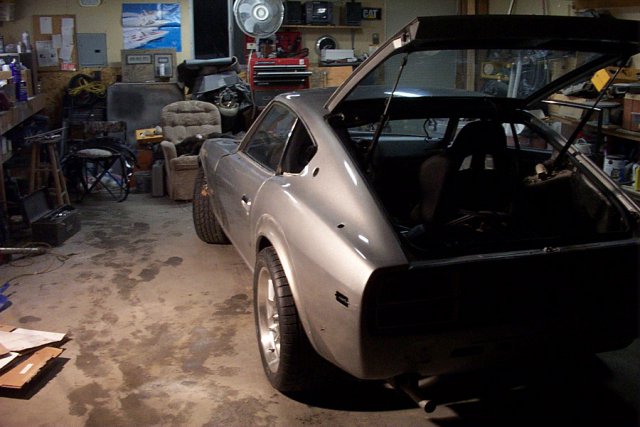

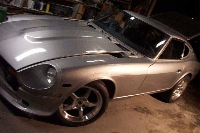

Metro Posted May 8, 2013 Share Posted May 8, 2013 I have 17x8 +17mm (245/45/17), 17x9 +17mm (275/40/17) Roh Snypers on my car and I think they would fit an unflared Z with coilovers. I picked them up as part of a group-by with some Supra guys about 8 years ago. The offset wasn't what I wanted, but the size and price fit, so I bought them and used spacers to fill out the flares. I'm pretty sure I have some photos with them on my car before I cut the fenders, I'll post them when I find them. Eventually I'd like to get away from the spacers and pick up some RBRs or something similar with the correct offset. Quote Link to comment Share on other sites More sharing options...

Metro Posted May 9, 2013 Share Posted May 9, 2013 Ok I lied, I don't think a 275 would fit without rolling the fender. I went through my photos and these are the best pictures I could find. The tire sticks out about 1" in the rear. The lip of the wheel looks almost directly in line with the fender too. Quote Link to comment Share on other sites More sharing options...
RebekahsZ Posted May 9, 2013 Author Share Posted May 9, 2013 Hey, thanks. That's not a lie-we call that mis-speaking now adays , haha. You can do that because of high ride height. Mine is lowered so I gotta fit INSIDE the fender. See my thread I started last night on 16x8s. Quote Link to comment Share on other sites More sharing options...
