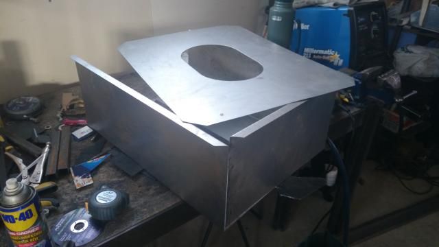

ls240z Posted February 13, 2015 Author Share Posted February 13, 2015 Still looking for a shop with a power break to bend the 12ga angle strips I need to mount my Bad Dogs, so in the mean time I've been cutting up 1/8" steel for the mounting plates/boxes for the main hoop. I am copying robbs70z's design, which is this: Here is my pile of puzzle pieces so far I also had my fuel cell container bent up. I picked it up today, they did a good job bending it. I just have to weld the sides, drill the cover holes, and get it powder coated. I'm getting an ATL Saver Cell, so I built the container before I bought it so I can mock up the fuel cell frame in the rear. This also saves me a bunch of money right now, and I don't waste the limited life span (5 year?) FIA certification. I also bought a 4'x8' sheet of 20ga steel, for the hatch floor, battery tray, and firewall holes. Slowly but surely, this build is finally going places. Quote Link to comment Share on other sites More sharing options...
ls240z Posted March 6, 2015 Author Share Posted March 6, 2015 So I finished up welding the container, it turned out better than I could have hoped. It was my first time welding sheet metal so I was a little nervous. All that I need to do is drill a drain hole, drill the holes for the lid, remake the lid (the old one was an 1/8th of an inch to small), and get it all powdercoated (going to wait on that, might as well do a batch of stuff to save money). Now that I have this made I can put together the supporting cage in the rear. Getting the angle pieces to mount my Bad Dogs made up and I'm picking them up on Tuesday, should hopefully be some decent progress in the next 2-3 weeks Quote Link to comment Share on other sites More sharing options...
