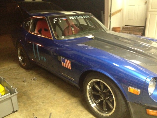

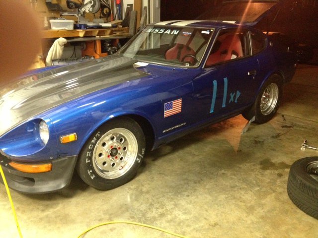

RebekahsZ Posted May 18, 2013 Share Posted May 18, 2013 Swappin' tires is all it takes to change from drag to autocross. Racin' in the rain AGAIN! Quote Link to comment Share on other sites More sharing options...
