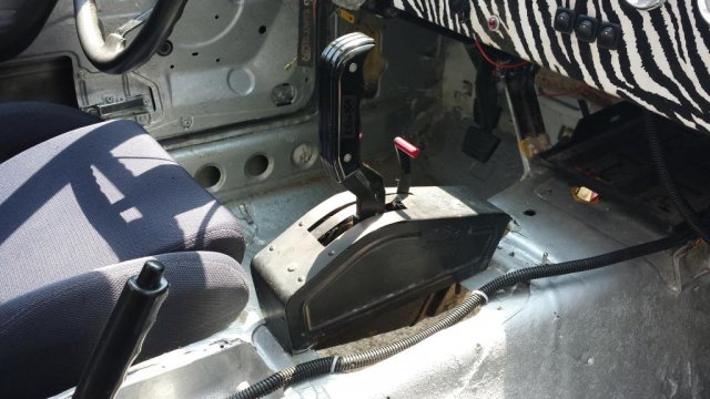

78zstyle Posted July 18, 2013 Author Share Posted July 18, 2013 Pulled the trigger on a rebuilt 4L60E. Can anyone show me pictures of what shifter they are using? Quote Link to comment Share on other sites More sharing options...
Robftw Posted July 18, 2013 Share Posted July 18, 2013 B&M stealth pro ratchet. you can modify the trans tunnel plastics to make it fit. This is a drag car so its gutted anyways Quote Link to comment Share on other sites More sharing options...
