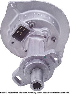

Metro Posted August 9, 2013 Share Posted August 9, 2013 On 8/9/2013 at 4:40 PM, alexx933 said: I'd have to change the shaft for the optical distributor? I might still have the 77, but I may have sold it along with the original motor and distributor shaft. The VR and 81 turbo distributors use a slot style input on the bottom of the distributor. The later 82-83 optical distributors use a star like input. I read somewhere it was to reduce play and provide a more accurate signal for the ECCS. Grabbed this off ebay, it's the bottom of the optical distirbutor: Quote Link to comment Share on other sites More sharing options...
alexx933 Posted August 10, 2013 Author Share Posted August 10, 2013 Seems like I will also be looking for that shaft then! Changing and aligning that shaft can be a pain in the ass too! On the plus side, it appears the star is symmetrical so there wont be a need for aligning the shaft. Just the rotor! Thanks! I really appreciate your help. Quote Link to comment Share on other sites More sharing options...

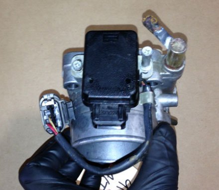

alexx933 Posted September 18, 2013 Author Share Posted September 18, 2013 So once again I have a very basic question: out of all the TPS sensors, which do I purchase? I have the option of a number of vehicles and various years i.e. 240sx, maxima, 300zx. Yet the TPS seems different slightly per application. I may be wrong in the idea that some TPS vary with year and transmission. But even so, the confusion has delayed purchase and continuation of my conversion. Which TPS should I be using? Oh! I did end up purchasing a new optical distributor and shaft. I figured there would be less backlash for this question by using this thread as opposed to starting a new one. Thanks once again! Quote Link to comment Share on other sites More sharing options...
Metro Posted September 18, 2013 Share Posted September 18, 2013 You need a potentiometer style tps. I used a 240sx TB and TPS. It will be three wires: power, ground, and the signal to MS. The sensor I happen to have looks just like the throttle switch on the stock TB, but it has a pigtail hanging off the bottom. You'll want to use the pigtail and not the three wire bosch connector. I think it's an on/off switch like the L28et's TB, either way it won't work for MS. Quote Link to comment Share on other sites More sharing options...
alexx933 Posted September 18, 2013 Author Share Posted September 18, 2013 I need a sensor and not a switch then. I don't plan on switching the TB at the moment as money is kind of tight. I plan on making small adapter plates to hold the newer sensor onto the stock TB. How do I tell that the TPS is the sensor type instead of the switch type? Or are the 240sx TPS both sensors and switch and that's why they have the Bosch style connector as well as the pigtail? I'm probably over complicating this. Quote Link to comment Share on other sites More sharing options...
Metro Posted September 18, 2013 Share Posted September 18, 2013 I might be confusing you as well. The pigtail hanging off the bottom is for TPS, the bosch connector is something else, all part of the same unit. Quote Link to comment Share on other sites More sharing options...
alexx933 Posted September 19, 2013 Author Share Posted September 19, 2013 It's helpful to know that your TPS has the pigtail! that means I can obtain a similar one rather than sift through all this. Thanks! Quote Link to comment Share on other sites More sharing options...
