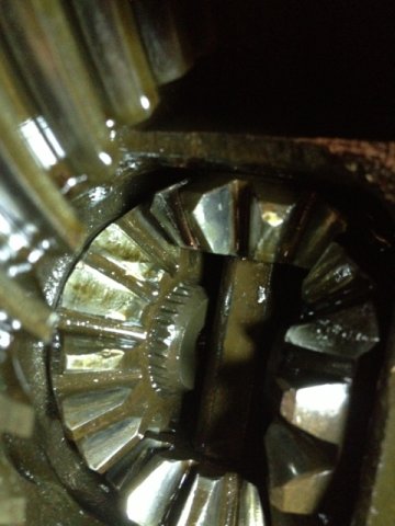

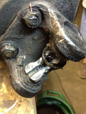

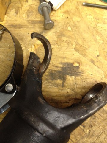

RebekahsZ Posted September 3, 2013 Share Posted September 3, 2013 The other V8 Z-car in my area had a drivetrain failure last week. He has a 350SBC with a T350 tranny in his 280z. Running open 3.54 R200 with stock halfshafts of unknown age. Unknown u-joint manufacturer. 2800 stall with 10" MT bias ply slicks at 20psi tire pressure. Looks to me like spider gears jammed from cross shaft wear. Broke a bunch of teeth off the spider gears and temporarily locked that axle, which broke the inside u-joint and mushroomed the halfshaft yokes. New (used) diff, replaced axle - back at the strip following week. Quote Link to comment Share on other sites More sharing options...
jt1 Posted September 3, 2013 Share Posted September 3, 2013 Looks like a good bit of wear on the spider gear teeth. Break on the launch? jt Quote Link to comment Share on other sites More sharing options...
RebekahsZ Posted September 3, 2013 Author Share Posted September 3, 2013 Half track was when the axle broke. The photo is bad-the teeth on the spiders aren't worn-about 1/4 of them are sheared off. Quote Link to comment Share on other sites More sharing options...
johnc Posted September 3, 2013 Share Posted September 3, 2013 That type of failure is generally brought on by long one wheel burnouts. Quote Link to comment Share on other sites More sharing options...
RebekahsZ Posted September 3, 2013 Author Share Posted September 3, 2013 Yeah, and I think he's gonna go thru another pretty quick. I was standing behind the water box (yes, I do get out of the belts and watch from time to time), and I watched him spin one wheel till it got hot, them it would hook up and then the other wheel would skin until it hooked up. I guess my CLSD isn't so bad after all. Quote Link to comment Share on other sites More sharing options...
