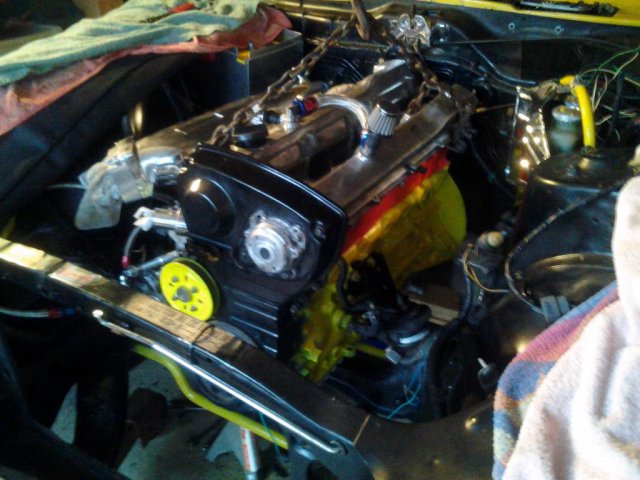

bumblez Posted December 1, 2013 Share Posted December 1, 2013 So what to do......got an rb25 , put rear sump oil pan on and test fit the monster.Only to discover what I had earlier thought, center linkage was in the way.yippee! Solutions? Quote Link to comment Share on other sites More sharing options...

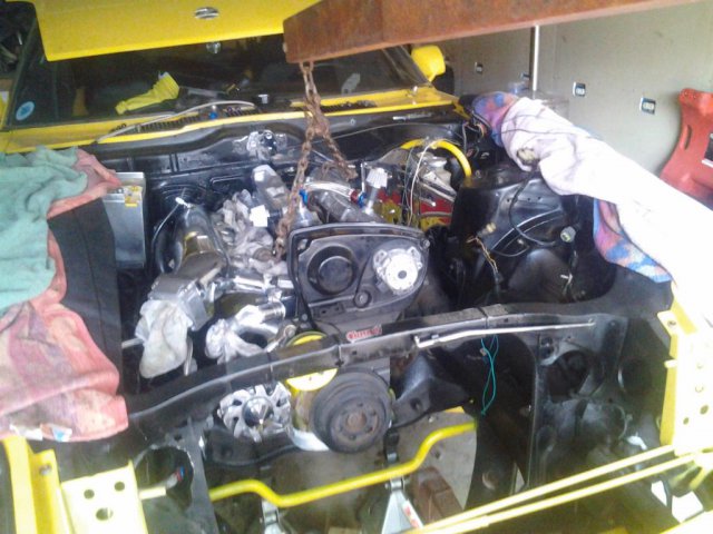

bumblez Posted December 7, 2013 Author Share Posted December 7, 2013 (edited) Hope i do this correct.I got a cx rear sump pan and due to 79 z center linkage pan had to be modified.This may b the most difficult part of this swap.(I HOPE)All plugs are hot that need power aic,vvt,inj.I used auto zone mounts (2429)only on one side in hopes to pivot motor away from massive steering box.options are limited on top mount turbo exsaust so ......if any one knows what will work for this application please post.These swap are nonexistent here in Arkansas. Edited December 8, 2013 by bumblez Quote Link to comment Share on other sites More sharing options...
feifongwong3 Posted December 13, 2013 Share Posted December 13, 2013 I have an 83 swapped, and just used the stock plenum, one of Pat1's pans, a pair of the 2429 mounts, and wired it all up. Been driving ever since, and saving for mods. Quote Link to comment Share on other sites More sharing options...
