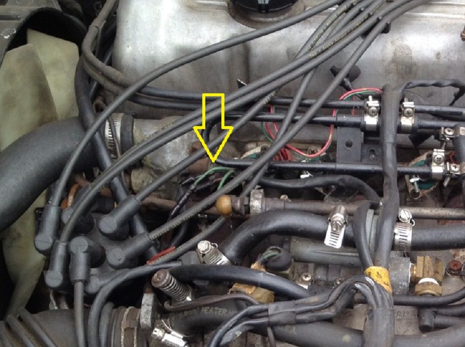

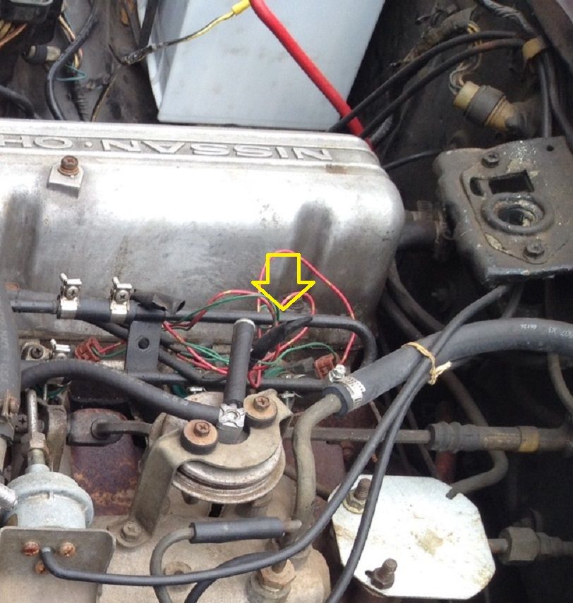

Qcsfinest280z Posted February 23, 2014 Share Posted February 23, 2014 I have been trying to comb through my 77 280z and I noticed these. Does anyone have any idea what these should go to? Quote Link to comment Share on other sites More sharing options...
jeremy93ls Posted February 23, 2014 Share Posted February 23, 2014 The second pic looks like you're pointing to the 'temperature sensor' wire and 'temperature gauge' wire. Check this page for better pics: http://atlanticz.ca/zclub/techtips/tempsensorpot/index.html Those are some funky fuel injector wires, huh? Quote Link to comment Share on other sites More sharing options...
Qcsfinest280z Posted February 23, 2014 Author Share Posted February 23, 2014 Thanks, that linked helped a lot. The previous owner did some bad work. Smh Quote Link to comment Share on other sites More sharing options...
jeremy93ls Posted February 23, 2014 Share Posted February 23, 2014 If you haven't yet, check out the tech tips on that site. It's a great resource http://atlanticz.ca/zclub/techtips/ Quote Link to comment Share on other sites More sharing options...
Qcsfinest280z Posted February 25, 2014 Author Share Posted February 25, 2014 Will the thermo time wires or water temp sensor wires keep the engine from starting? It cranks fine just can't get it to start. Quote Link to comment Share on other sites More sharing options...
Pharaohabq Posted February 26, 2014 Share Posted February 26, 2014 It looks like they replaced all the injector plugs. Those wires look like they're to the injectors. The L28 system works by it Grounding each of the injectors as the engine turns completing the circuits so the injectors would fire. Who knows if they did it right or not, you'll have to look at the wiring diagrams to be sure. As for starting, Do you have Spark? Do you have Air? do you have Fuel? You need those things to make the motor go. When it cranks, do you smell gas? If you get starter fluid and spray it into the intake then crank the engine, does it try to run? These are the questions, you provide the answers, then we'll ask more.. Phar Quote Link to comment Share on other sites More sharing options...
