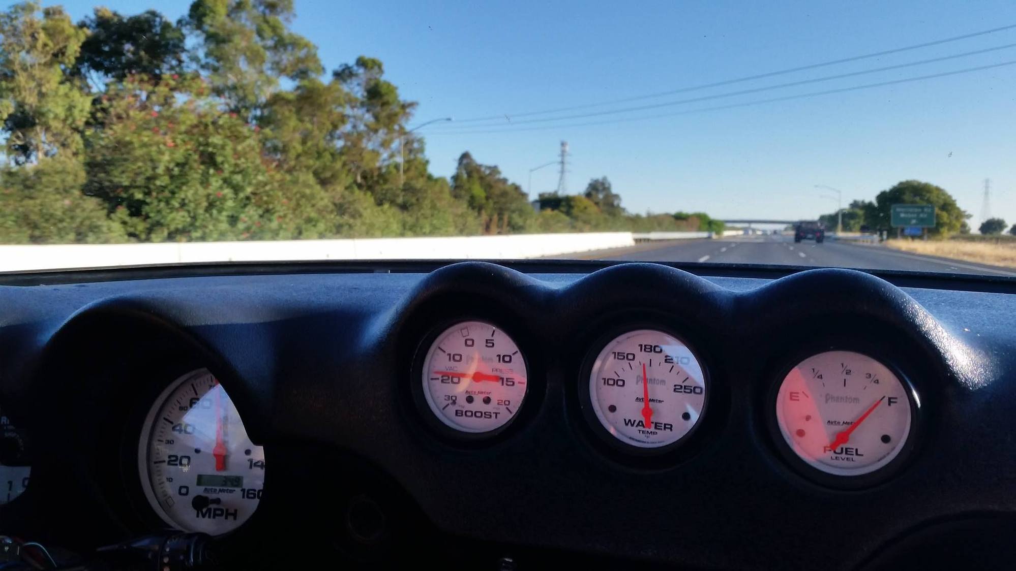

mistafosta Posted February 22, 2015 Author Share Posted February 22, 2015 Made a few dyno passes, but ran out of injectors (80lbers). Maxed out in the low 900rwhp. The tuning was done by Nate at AOP in Fresno. Car drives like its stock, but makes an insane amount of power.After that, the only thing left to do, was go to the track again!Car drove nicely the 100 miles each way. This is about as hot as it got, which considering the blower setup ran around 215 on the freeway was AWESOME.Car did well, still only 15-16lbs of boost, but we adjusted the suspension a bit. I plan on going a bit faster this year. Video here: https://www.youtube.com/watch?v=DyX5XkKVZ-k I believe this pass is the fastest pass for an LS powered Datsun to date.Sadly, a few passes after my 8.7, I saw a drop in oil pressure on the return road (About 15 at idle down from 30), so I trailered the car home. Motor still ran perfectly, but I didn't want to hurt anything. I was planning on refreshing the engine and going for low 8s, but I picked up a new motor to play with so now I'm going to either sell the longblock as it sits if anyone is interested, refresh it and sell it for more money, or part out all the components. Quote Link to comment Share on other sites More sharing options...

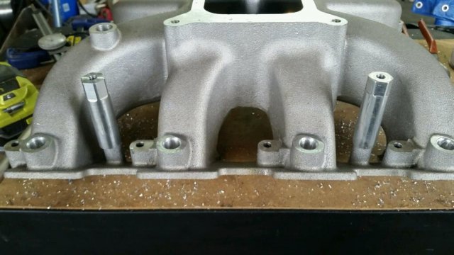

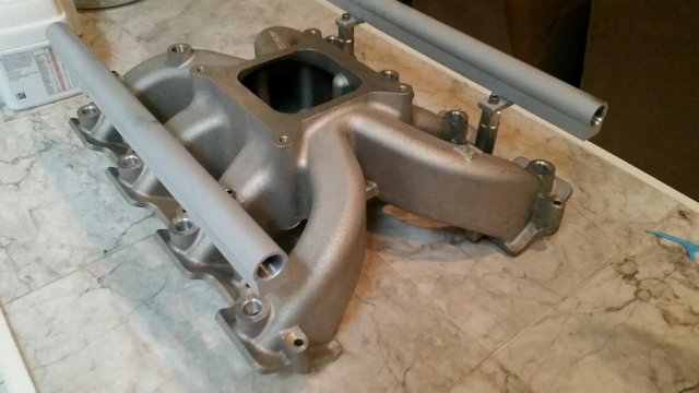

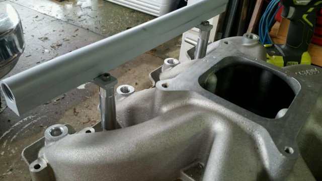

mistafosta Posted April 28, 2015 Author Share Posted April 28, 2015 Got a new intake setup. Wasn't a fan of the ls7 I had so I figured this was the best way to go. Quote Link to comment Share on other sites More sharing options...

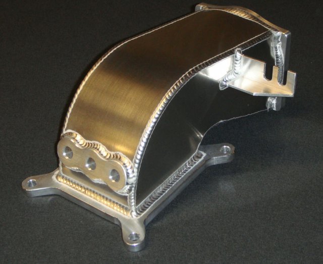

Dingo Posted May 19, 2015 Share Posted May 19, 2015 Mistafosta, do you have any post-repair pics of your frame rails? The very first pic you posted of the front frame rail/firewall area looks like my driver side area that i'm about to start repairing. Good build by the way! The welds on that new upper intake piece are amazing. Quote Link to comment Share on other sites More sharing options...
