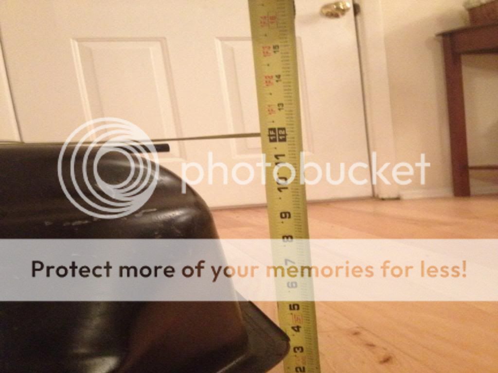

Does anyone know the depth of the widest part of the s30 fuel tank from top to bottom is? 10inches? 12inches?
I want to install Aeromotiv phantom in tank fuel pump but the kit requires a depth of no more than 11 inches. anything passed 11 inches wont work.
I was just past the sweet spot. It's like 11.4" internal once you cut the hole on my 260 tank. Luckily, if you, like me, already have the Aeromotive kit they sell an extension kit with longer wires, plumbing, and baffle. It is an extra $162 bucks but there is hope.
