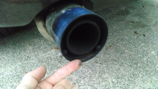

4. Are you getting soot on or around your tailpipe ? If so this is an easy check for a super rich condition.

4. There is Black soot around the end of the tailpipe.

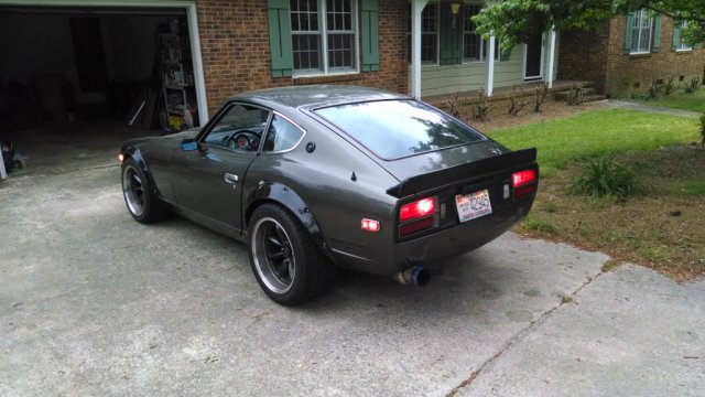

So I worked on sealing the back of the car some more today as I found a couple of new areas that it could be leaking in through. I also installed the BRE style spoiler which doesn't really fit right, but neither does the bumpers or the flares from MSA so that's not new. I think I made some progress as far as the fumes being pulled in through the back as it seems that it has diminished quite a bit. I can still smell it a little here and there and my nose has been a little stopped up since I drove it around the block but it is still a good step in the right direction. I took a picture of the tailpipe to show the soot.
