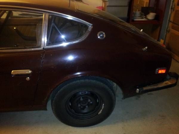

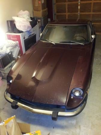

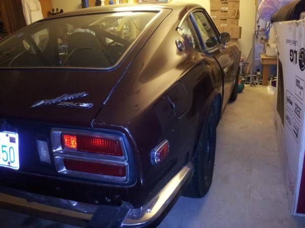

I am so confused.  I have a 260Z that I am looking to buy it has low vin number in the RLS30-0043XX .  It has a front  that has the turn signals below the bumper but the rear has the shock absorbing dampeners.  The rear quarters are recessed for what appears to be 240Z-style flush bumpers.  Can someone please explain why it seems this car has both "early" and "late" 260Z characteristics?
That's an ealry 260, I have one. As far as I know all early 260s have thos bumpers, There kinda like 240 but attached to shock absorbers with filler panels behind them. Later 260s had full tilt park bench bumpers like the 280.
