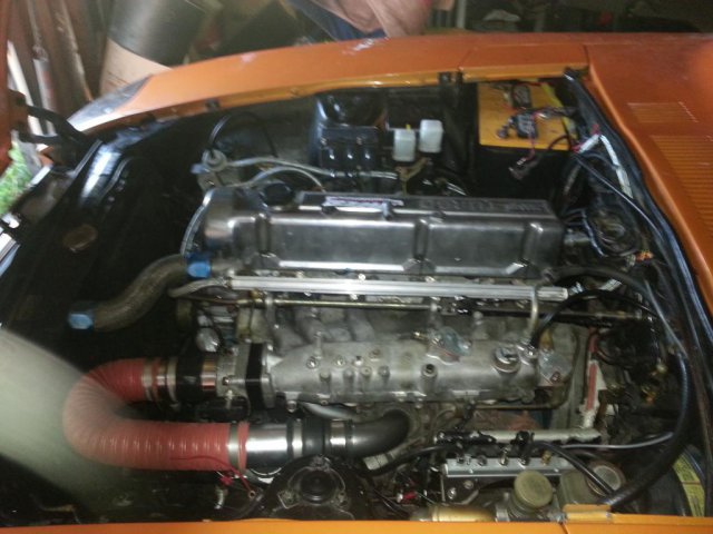

Hi, i hope somebody can help me out with my 36-1 trigger wheel.
The car is a 280z with 81 turbo L28ET engine with MS2Extra, IGN-6, trigger wheel from DIY and a sensor "PNP" that i brought home from work, im working with Automation (swisslog.com)
I have AC and still want to use that, so i timed it up and i set the missing tooth together with the VR_pickup on the TDC mark "0" but that didnt work out to well.
so i moved the wheel with missing tooth down 7 teeth (anti clockwise) because i tryed to put it up til 12 o,clock aprox and then i had 7 tooth and changed
the angle to 70 degrees it didnt work either, thats why i tryed to put it the anticlockwise 7 tooth from TDC mark. What should the angle be?
70 degrees or 290 degrees??  Can i put the missing tooth where ever i want and just count the teeth to TDC?

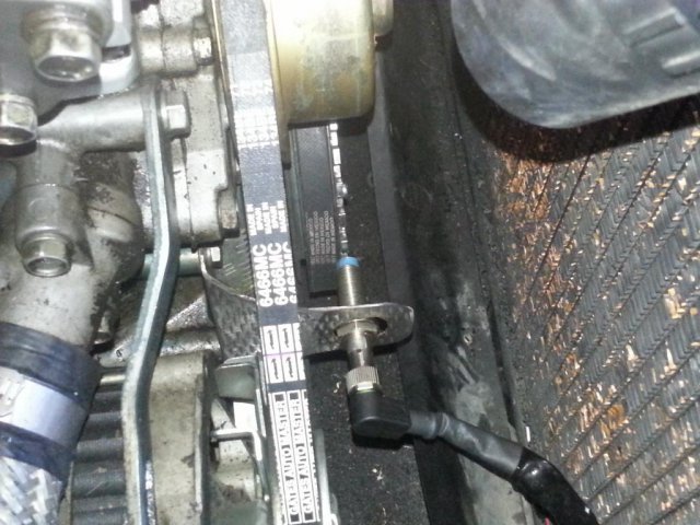

Anyone got any good pics of how to set up the sensor on the alternator side, not AC side, where the missing tooth should be and settings in tunerstudio.
At least i got the car started, the timing was off, it doesnt mather if i set 70 degres or 290degrees, it still splutters and backfires.

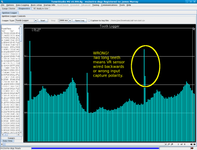

I started Trigger/tooth logger but at every time the missing tooth apears it comes with 2-Long spikes, Why???,
it should only be one -1- correct? with 35 small one between.

From what you've told us, 70 sounds correct for the #1 tooth angle. With a 36-1 wheel you should see 34 short teeth and the 35 tooth will be twice as tall as the rest. If you're seeing multiple long teeth back to back, MS is losing sync. Try adjusting your sensor's air gap. Then try adjusting the trim pots on the board.

I Think maybe that the VR sensor is wired backwords, since i get 2. Spikes at the missing tooth, i will try to change that later on today/tomorrow.[/background]
It backfires and another question is where the missing tooth should be, Think of it as a clock, my TDC is at 10 o'clock and my VR sensor is almo at the same position since i dont want to have the VR-sensor on the other side where the AC-pump is. where should the the missing tooth be 3-4-5-6-7 o'clock. i can count the tooth myself up to where the VR is when i get that far. [/]
