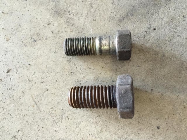

wayverippah Posted March 24, 2015 Share Posted March 24, 2015 Hi all. I just pulled my front struts off of my 77 280z to do a coilover install, and found that the bolts connecting the hubs to the rotors are different between the driver and passenger side. The hubs are identical in measurements minus the bolt size. Is this normal or am I missing something? Quote Link to comment Share on other sites More sharing options...
johnc Posted March 24, 2015 Share Posted March 24, 2015 Not normal. Quote Link to comment Share on other sites More sharing options...
RebekahsZ Posted March 24, 2015 Share Posted March 24, 2015 (edited) Top bolt is factory. Somebody has done a repair on the hub associated with the lower bolt. It probably doesn't matter if they did a nice job drilling and tapping it for the new thread pitch. If the bolts go in smoothly by hand, I'd run it. Unless you just really want another project (that doesn't net a performance gain). Edited March 24, 2015 by RebekahsZ Quote Link to comment Share on other sites More sharing options...
ReeNerf Posted March 24, 2015 Share Posted March 24, 2015 Are the hubs from the same car? Quote Link to comment Share on other sites More sharing options...
wayverippah Posted March 24, 2015 Author Share Posted March 24, 2015 Yeah same car. They thread in fine, just need to drill out the rotors to get it to fit. Might find a used hub to replace it with... Thanks for the info guys!! Quote Link to comment Share on other sites More sharing options...
