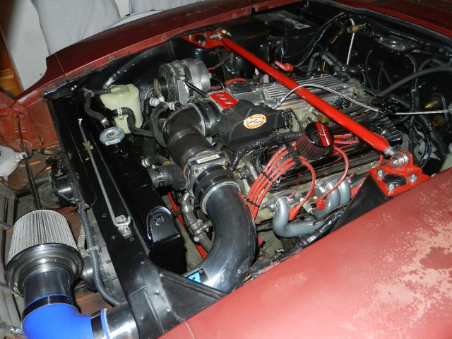

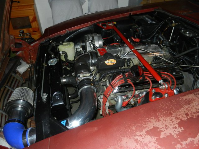

hcarrickz3 Posted May 22, 2015 Share Posted May 22, 2015 Just Finished up with the same swap as you are doing, 94 Z28 with the 4L60e. Quote Link to comment Share on other sites More sharing options...
hcarrickz3 Posted May 22, 2015 Share Posted May 22, 2015 Here are a couple pic's used stock Datsun radiator with the Camaro fan setup. Stock 280z shifter, All stock gages were keep and are working. Quote Link to comment Share on other sites More sharing options...
