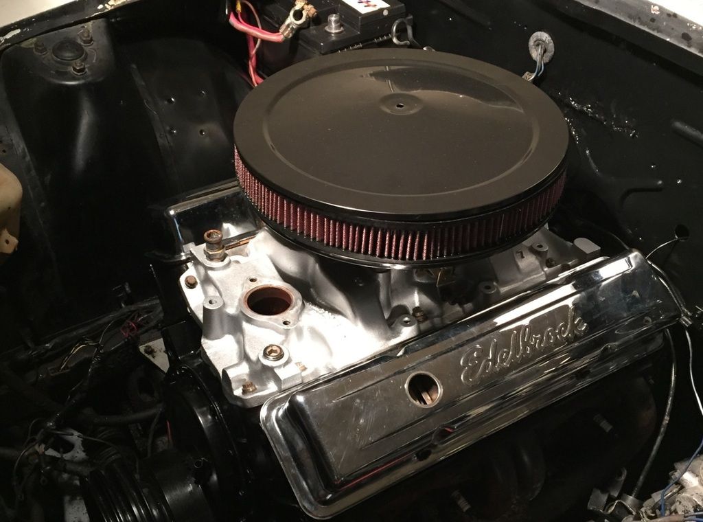

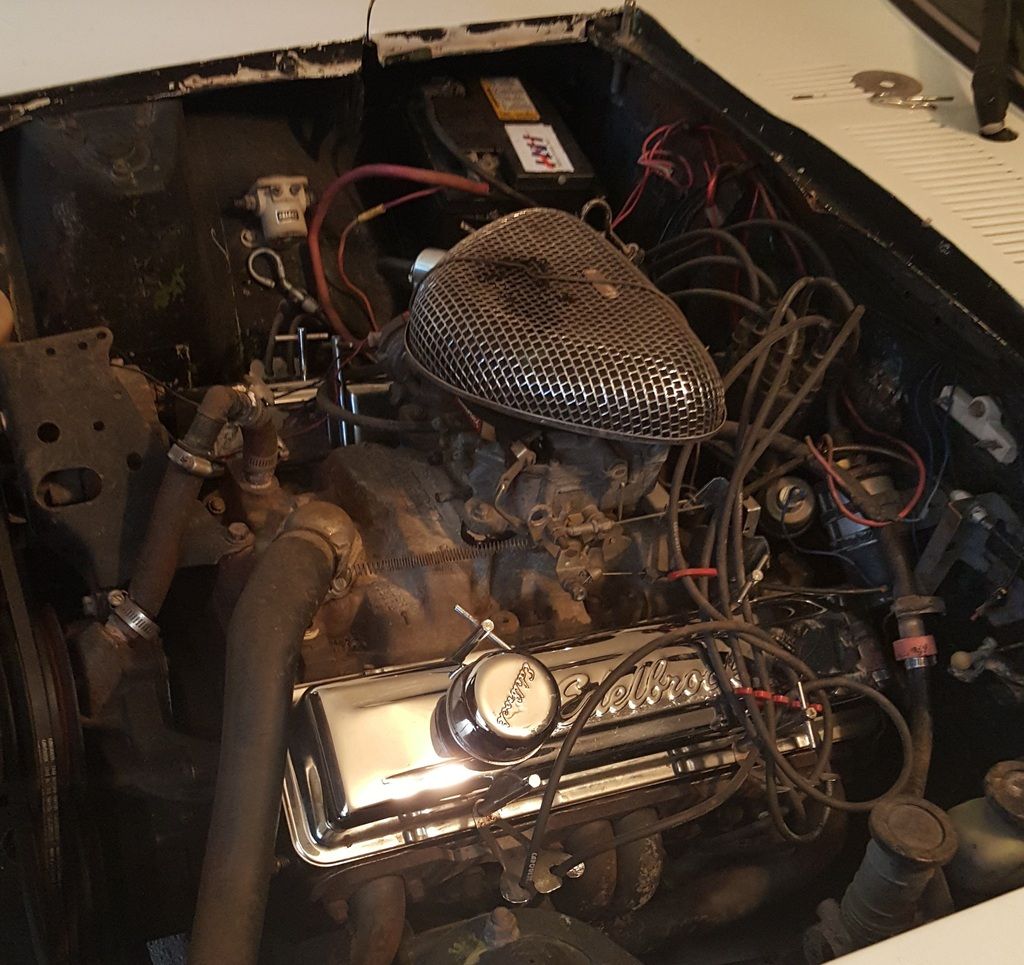

Existing Engine:
     350 SBC (Casting 14010207)
          Weiland Intake Manifold
          Edelbrock 4 Barrel Carburator
Before & After Paint: I painted the firewall and engine with duplicolor high temp paint.
When I install the new motor, I plan to have everything sandblasted and repainted.
