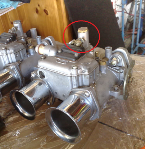

Hey all, I have triple Dellorto dhla's,but I had to switch the top cover on one due to the person I purchased them from failing to notify me of a broken float pin arm. Anyhow, I switched everything over except I can't figure out how to swap over the fuel enrichment device. I removed the nut holding on the linkage, and the cap on top as well as the spring that presses on the piston, but I can get out that piston or the arm where the linkage slides on. If anybody has any idea how to switch this over I'd greatly appreciate it. I know that they don't need to be used, but I do need to have it there on the new top cover. Thanks for any help.
