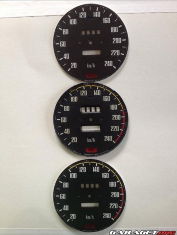

Andreas Posted July 12, 2015 Share Posted July 12, 2015 Here you can se the calibration factor on km/h plates. Quote Link to comment Share on other sites More sharing options...
