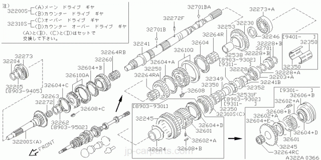

The ring gear inside the transmission is also damaged...
Searching around online it looks like the part I'm after is a  32701-66005  OR 32701-E9800. I believe the E9800 is either an updated part or an updated part number  from what I've found online.
I happen to have an F4W71B and F4W71A hanging out in the garage. Is there any chance this might speedo ring drive gear could be the same part? I havn't been able to find a part number for either of those transmissions.
Also, since I've never pulled a trans apart before, is it possible to pull out pull just the rear housing off this one to pull a retaining spring, old gear and slide in the new one?
