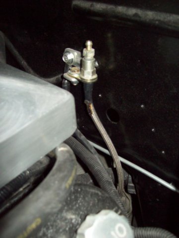

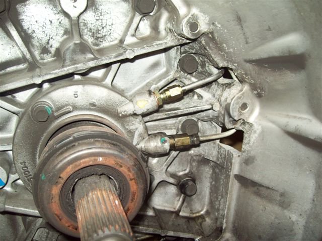

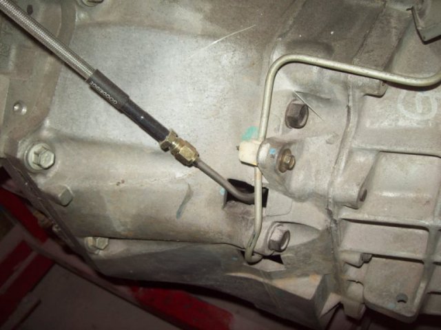

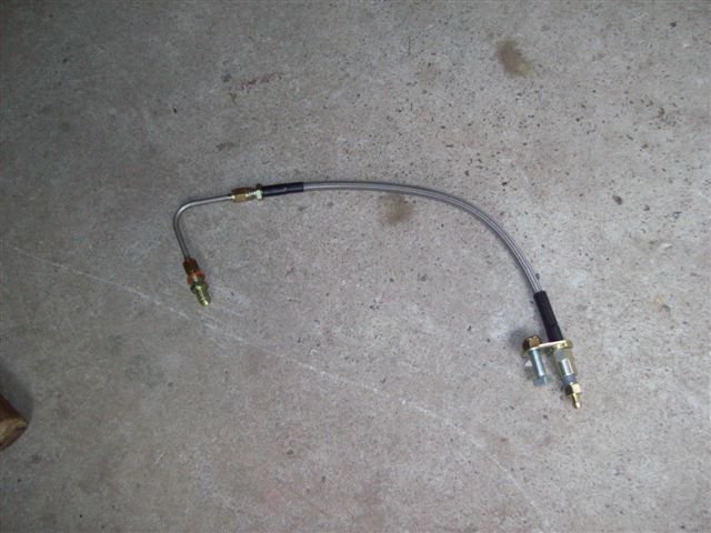

For the master cylinder I used the one from the donor car = GTO
For the bleed line I used bundy tube (approx, 100mm - 60o bend - 100mm) then flexible hose. I ran the hose up the firewall for easy access.
My car is RHD and I retained the original bundy tubing across the top of the transmission, however, getting access to the bundy/flex hose junction was a PITA and I'll swap it for a full flex hose similar to the bleed line when I next drop the transmission. This may not be an issue for a LHD car.
