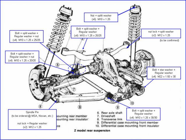

Milenko2121 Posted September 9, 2016 Share Posted September 9, 2016 Apparently one of the giant bolts managed to wiggle itself free and is now gone forever. Does anyone know what size these are so that I can get a replacement? Quote Link to comment Share on other sites More sharing options...
ritrebor Posted September 9, 2016 Share Posted September 9, 2016 http://forums.hybridz.org/index.php/topic/98751-suspension-bolts-inventory ritrebor Quote Link to comment Share on other sites More sharing options...
Milenko2121 Posted September 9, 2016 Author Share Posted September 9, 2016 Ah, perfect, I had found that thread before, but missed this image. For anyone who stumbles on this M22x1.50x30 Quote Link to comment Share on other sites More sharing options...
