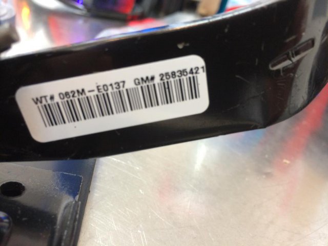

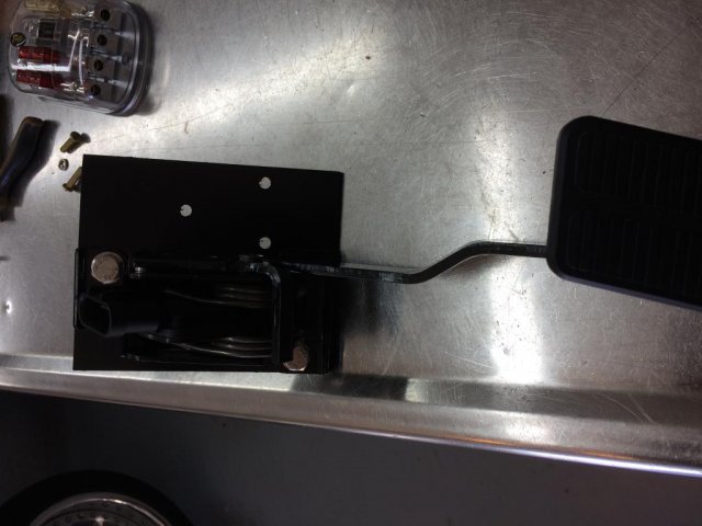

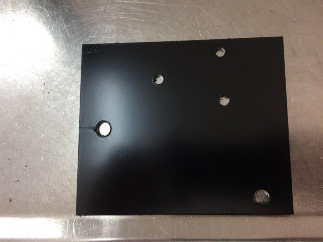

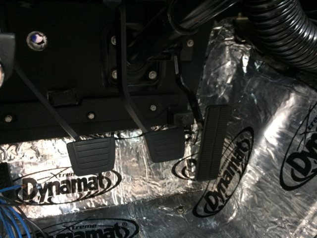

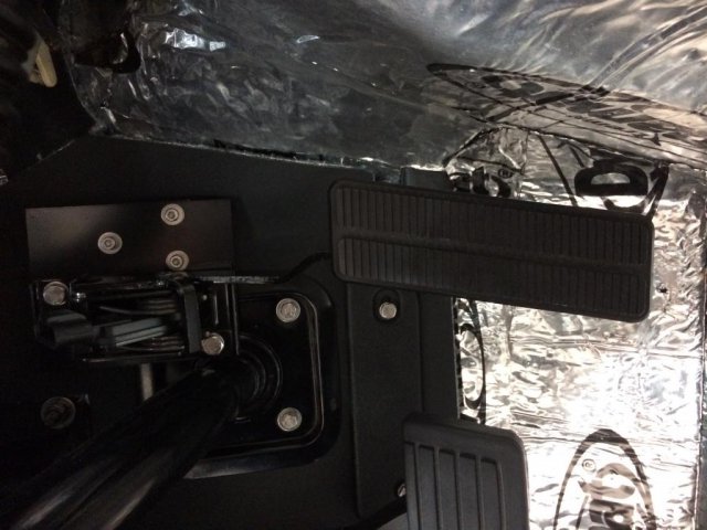

alainburon Posted October 10, 2016 Share Posted October 10, 2016 This what I did with mine, I used the factory mounting holes because I did not want to drill any more holes in the firewall.. I just made a steel plate and drilled it to fit the pedal and the original mounting holes. It's very sturdy and I think it does not look bad. I'm not sure what car the pedal fits but I took a close up picture of the part number in case this works for you. Quote Link to comment Share on other sites More sharing options...
Ryan Merrill Posted October 10, 2016 Author Share Posted October 10, 2016 Exactly. I was concerned placing it over the steering rubber. You setup look perfect;y placed. I have the big plastic pedal. Quote Link to comment Share on other sites More sharing options...
