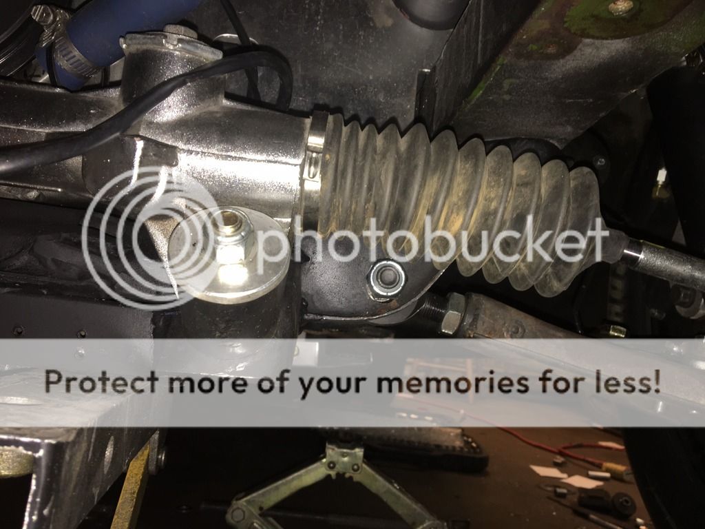

I am running an LS, but it's setback in the chassis, and the manual pinto rack has tons of clearance
And I have reamed my steering arm for the pinto balljoint. But from the overall width of the pinto rack, I'm not sure there is enough thread on the inner tierod, versus getting the bump steer kit installed safely
In the beginning I wanted power steering, so I installed the Forester rack, but then decided that I wanted the manual system back. Since the 240 rack was gone, and buying one used and rebuilding it was more money than the pinto rack, I installed the pinto setup. After looking at pics I thought I was close to the stock position when welding in the mounts
So yesterday I spent most of the time trial and erroring different spacing and positions. My initial setting would give me almost 3/4 inch toe out on the rebound hieght the car drives.
I then spaced the balljoint down, the LCA arm down in various positions. Finally I found a setup that gets me 1/16 toe in and 1/16 toe in at both positions of compression and ride height rebound
That setup is, pinto ball joint in positions with no spacers bolted up. LCA is spaced 1/2 inch down. I moved my rack up as far as I could within the bushing slot I can fix the rack positions easy, I'm at the point of either buying a 1 inch LCA spacer and machine it down to a 1/2 inch or just Drill a new hole in the cross member for the LCA pivot and bolt the arm to the spindle again.

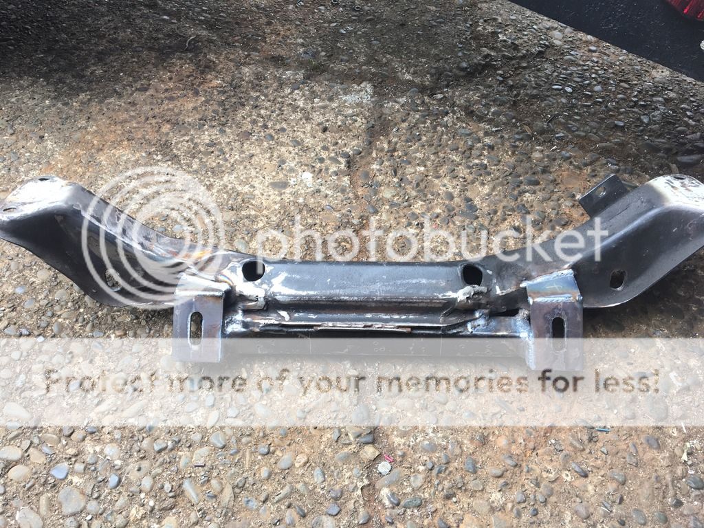

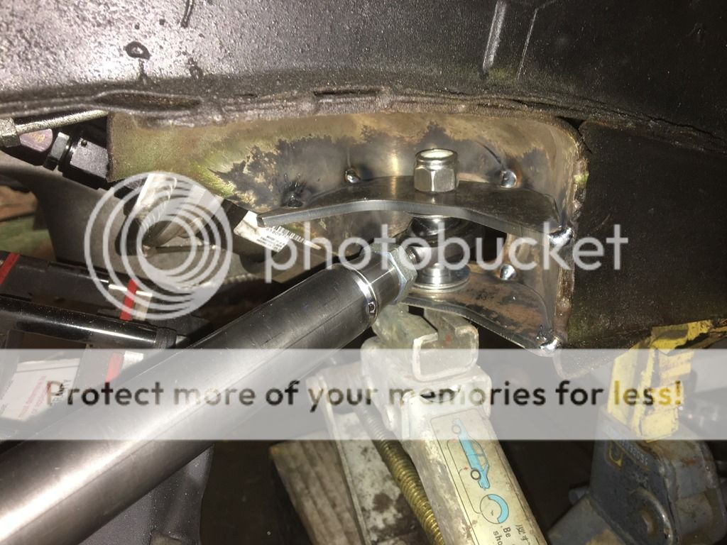

Got this just about sorted. Pulled the cross member, welded on new slotted rack mounts, slotted the control arm mount and ended up fabbing my own caster rods. Turned out alright, and initial garage alignment shows 1/16 toe in at ride height and at rebound height I get 1/4 inch toe in
I'll make a few 1/8 mile hits on this setup, collect some data and get the car aligned proper
