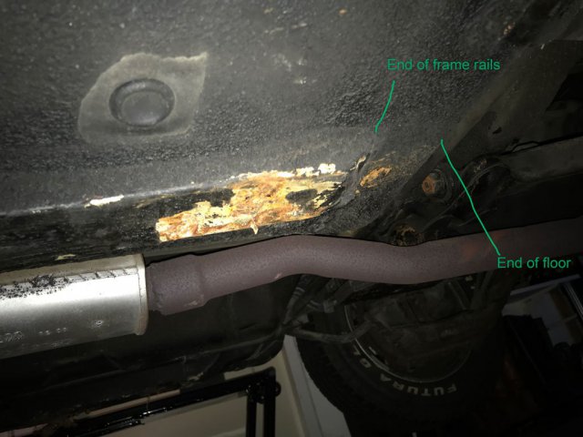

Hi guys,
Does anyone know why the frame rails (aka floor supports) don't run de complete length of the floor pan in the rear? They stop around 3 inches in front of the end. See picture.
I need to replace those end sections I was wondering if I can just extend them to the end because I think that will give extra strength. Or is there a good reasons they don't run to the end?
Thanks!
Reinier
Amsterdam, The Netherlands
Sure you can extend them to back. There is even aftermarket bits to lenghten them. " baddog frame rails"
I can't find any reason why they don't should not be extend.
I have done that with square tube front to end.
