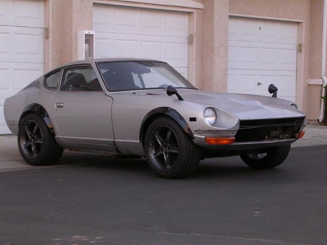

Z-TARD Posted July 6, 2005 Share Posted July 6, 2005 Pics: And one of my new bumper I made for my cherokee last week, just because. Mike Quote Link to comment Share on other sites More sharing options...
CruxGNZ Posted July 6, 2005 Share Posted July 6, 2005 Nice! I guess you don't need deep dish wheels with ZG flares for a Z to look bad@ss You wouldn't happen to have a shot from directly behind it, maybe 20 feet away, and from like 2 feet off the ground, would you? I would love to see what those steam rollers look like! That would be such a cool picture. Hey Tim, check it out, he has wheel chocks! !M! Quote Link to comment Share on other sites More sharing options...
DavyZ Posted July 6, 2005 Share Posted July 6, 2005 Pics...And one of my new bumper I made for my cherokee last week' date=' just because. Mike[/quote'] Ah, me like! Car looks menacing in silver and black--true Raider colors! You must be a fan!!! j/k Seriously, nice work on the flares and I think they look great in black---did they arrive that way? I wish mine did!! Bumper for Cherokee came out great too. There have been a number of Zs in the Bay Area that sport a tubular bumper, bent to conform with the body and probably work a whole lot better then the stock ones...any chance you will fab some steel ones for your Z? Davy Quote Link to comment Share on other sites More sharing options...

Z-TARD Posted July 6, 2005 Share Posted July 6, 2005 Ah' date=' me like! Car looks menacing in silver and black--true Raider colors! You must be a fan!!! j/k Seriously, nice work on the flares and I think they look great in black---did they arrive that way? I wish mine did!! Bumper for Cherokee came out great too. There have been a number of Zs in the Bay Area that sport a tubular bumper, bent to conform with the body and probably work a whole lot better then the stock ones...any chance you will fab some steel ones for your Z? Davy[/quote'] As they sit is exactly how they arrived, the gel coat is really well done on these. I could probably get away with leaving them with just the gel coat, but I'll probably end up painting them since it will be easier than polishing out all the fine scratches and dings I made on them during installation. I've been seriously thinking of making some bumpers out of 1"X2" rectangle tubing. Something very close fitting and simple, probably either black or color matched to the rest of the car. A round 1.5" tube bumper would also look pretty cool if done right. Or if I move away from California before I get done with the car, no bumpers. Mike Quote Link to comment Share on other sites More sharing options...
