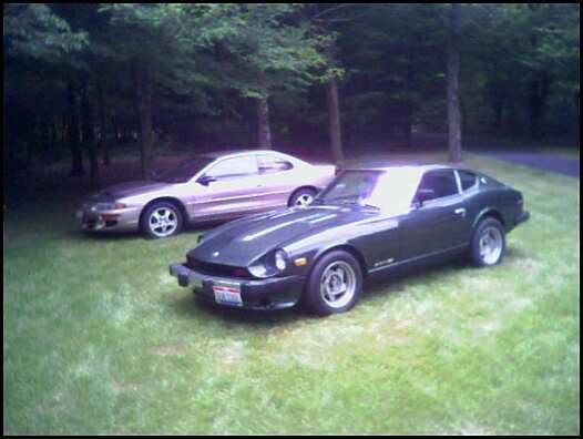

nienberg.11 Posted February 10, 2006 Share Posted February 10, 2006 MIB, Here are some pics of the car. I'm at school now and don't have any real good pics of the wheels, and the one pic was taken w/ a camera phone, so I apologize. If you want, I can get some good closeups of the wheels the next time I'm home. I also don't have any before pictures of the wheels, but the whole wheel was bronze with the exception of the shiny outer rim. This didn't match my paint at all, and the epoxy was starting to peel/bubble, so having them blasted was a big improvement in my case. It wasn't a perfect solution, though. Some of the sand reached the shiny outer rim and dulled parts of it from inadequate masking. Also, as you can see in the pictures, the front wheels now collect brake dust pretty quickly as the inner part of the wheel is now pitted. I've thought about cleaning the wheels up and painting them clear to alleviate this, but I don't know for sure how well that would work. Anyways, here are the pics: Quote Link to comment Share on other sites More sharing options...
