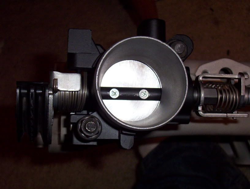

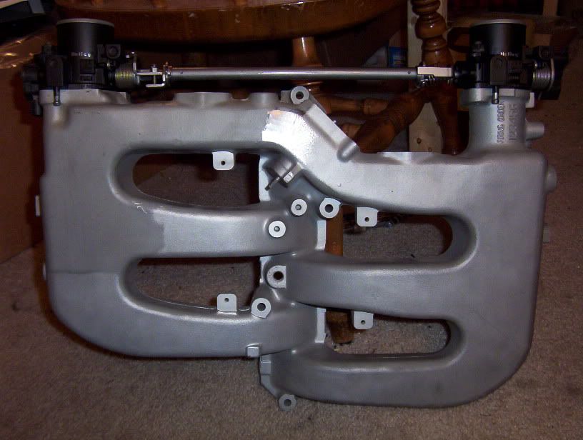

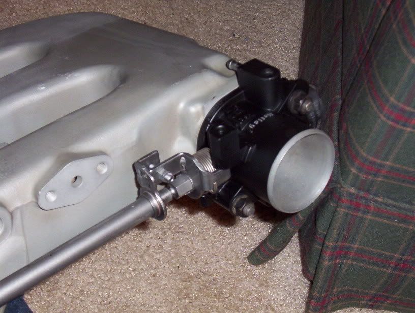

I spent last night rebuilding and cleaning the Throttle bodies for my daily driver. I mentioned this setup to Braap earlier and thought others might be interested as well. I got the intake manifold, TBs, and all the sensors attached to the intake at the local junkyard for $50! If you've always wanted a dual TB intake for your project but couldn't source the parts, check out the first gen (93-97) dodge intrepids at the j/y. The 3.5L engine that these parts came from was installed in all LH series cars and is rather abundant. The setup is very similar to the one found on the early Vipers. These TBs are 48mm but I can get bolt on TBs up to 58mm at the junkyard and there are some aftermarket parts that will go higher than that, so size is not a problem. Anyways, I just thought someone might be interested in seeing this.
