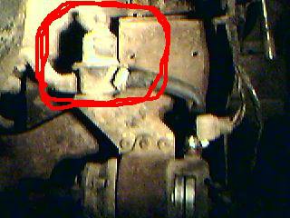

Just as the title says. I got my gas tank off, and this is on a bracket above the fuel pump. Im lookin for blockage in my fuel system. I have only 10psi. Is this an essential part of my fuel system, or can I bypass this? I just steamed out the gas tank, and this looks to be easier dealt with with the tank off. Could this be a factor in my plugged fuel system? Thanks!

Sorry. Only camera I had on hand was my phone. Thank god it has a USB port on it to offload pics. So a strainer, eh? I woulda guessed it was a regulator of some sort.

Just got ahold of an old Haynes. Apparently thats a fuel filter??!!?? What a dumb place for one of those. I wouldnt have ever seen that if I hadnt pulled the gas tank. Anyone confirm thats what that is??

So I take it thats a necessary piece of equipment. Not something I wanna bypass? Could those get plugged up/anyone had one fail?

Alright. Ill check if its a problem before the tank goes on. The tank turned up rust free inside. The outside is in good shape also. Still has the undercoating on it. Ill try it all out Saturday morning, and hopefully have a running Z this time around. Thanks alot nienberg.11. You been a great help!
