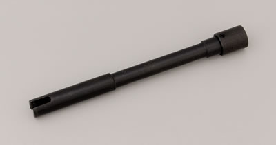

prefered
http://store.summitracing.com/partdetail.asp?part=MEL%2DIS%2D55E&N=700+115&autoview=sku
notice the STEPPED DIA. thats to prevent the middle of the shaft rubbing on the block near the crank bearing area,non stepped dia shafts DO tend to rub ESPECIALLY on the 400 blocks
