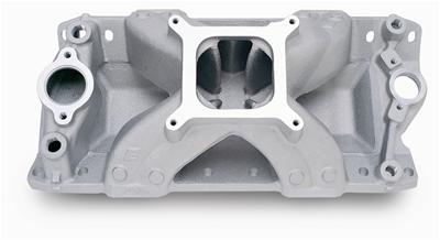

(1)
EDL-2925 $209.95
Ive used these alot till now, they REQUIRE extensive clean-up work but produce good power

Other than the fact these were used on a N2O motor I would think they are all a mismatch for a 383+ cube motor with a cam in the 240'ish duration range.
250* @.050 in a 400 cube motor is a street/strip cam and would peak before 6500 rpm, not in the 7000-8000 rpm range. This range would be better served with a Edel RPM style, Stealth, or Holley 300-36 dual plane.

first let me point out that Im sorry for the confusion here,
(the intakes are generally LISTED/ADVERTISED AS good for the 3000rpm-8000rpm band) my engine combos USEING them generally run in the 3500rpm-6500rpm range)
I don,t have a scanner but Ill see If I can get the info posted
as to the "Edel RPM style, Stealth, or Holley 300-36 dual plane."
, your correct, if these were N/A engine combos, but the combos were DESIGNED to use a 200-250hp shot of NITROUS, not run N/A, and have consistantly shown better results with those single plane intakes
