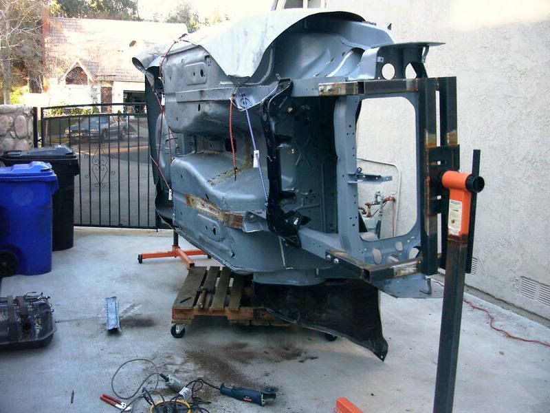

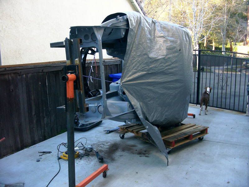

So I got back to my Z recently. It's been too darn cold and windy to be working outside lately. I built the rotisserie a while ago, and recently mounted the car onto it. I removed the hood latch bracket, trans mount, and other assorted odds and ends. Last night, I made a new floor pan for the passenger footwell, and I welded it in today after work. Anyways, here are some pics of my progress.
I know my neighbors have got to love this

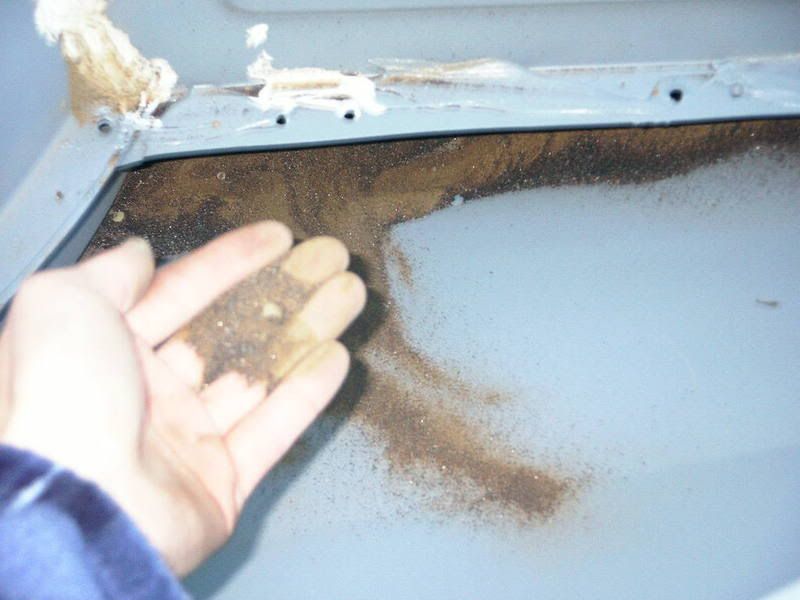

Everytime I turn the car over, I get about 10 more handfuls of this

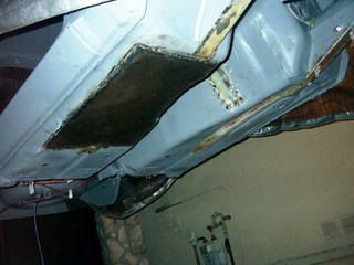

This area has me a little confused as how to go about removing the rusted floor pans, what with the frame rail being right there. Suggestions?

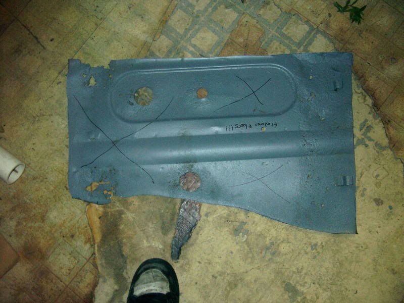

Bad floors come out
zrotisserie025.jpg">
New metal goes in...
zrotisserie031.jpg">
zrotisserie033.jpg">
And before anyone points it out to me,yes I know it's not the greatest idea in the world to use flat sheetmetal for a floorpan. I was going to go buy a little vice mounted bead roller, but ended up not. The subframe connector is going to be going right down the center of the flat piece anyway, so I don't think it will cause a problem.....I hope.
