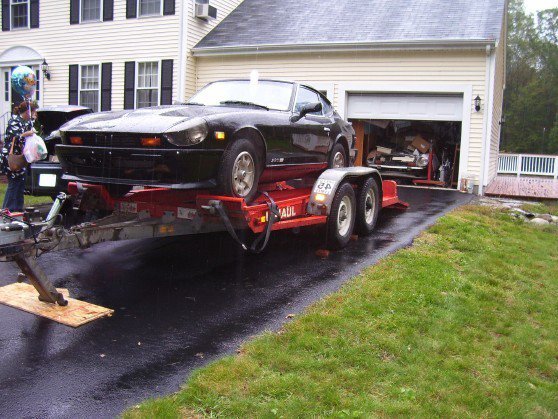

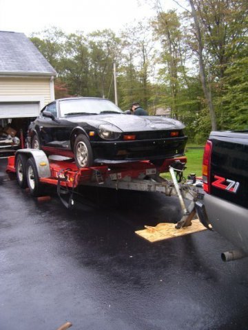

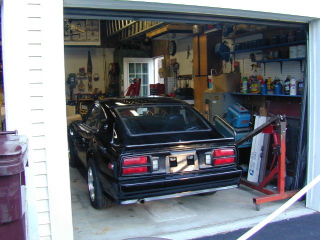

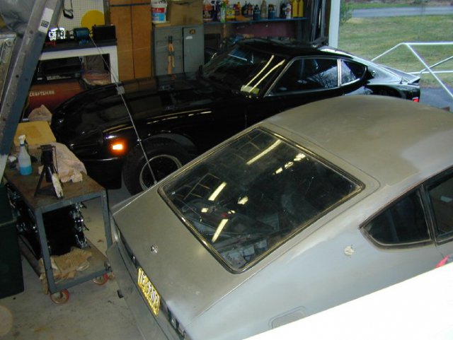

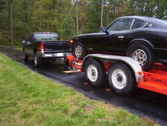

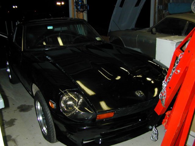

To start are Pics of the 76 280z coming home on the U-Haul and you can see the buried 78 280z in the garage which is cleared out now and both Z's are in the gargae right now. I bought a tent/garage to move my 78 280z outside for the winter as the WIFE insists that her new 35K Infiniti G35X use the other side of the garage for the winter. So I have to button up the Old Z first and setup the garage tent in the next week or two.

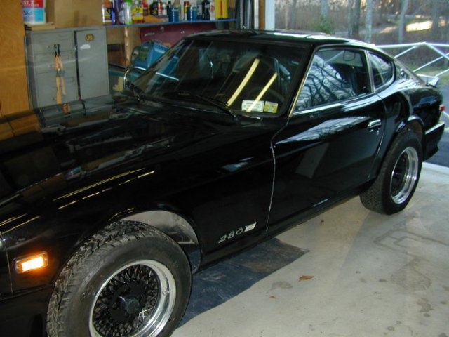

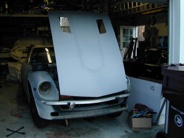

Well I cleared off all the crap that was piled on top of my old 78 Z, started it up and moved it over a bay and pushed the 76 HybridZ project in to the garage. I swapped my old 15" Enkei wheels off my 78 and put them on the 76 to see how they look. It will look better once I lower the car I think.
Next is to set up the tent/garage and put my old 78Z in there for the winter so my wife can park the Infiniti in the garage.
Once that is done I can pull the motor and trans out of the 76 HybridZ.

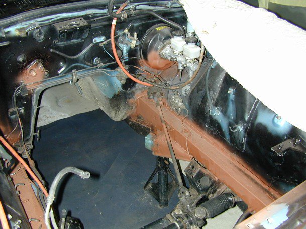

Cut off the old transmission mounts to make room for the T56. I hope I cut off enough but I would like to keep some strength if possible.
Jason did a nice job welding in new sheetmetal in the battery tray area. I started prepping the engine bay for paint.

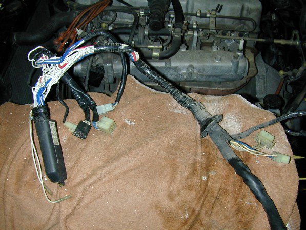

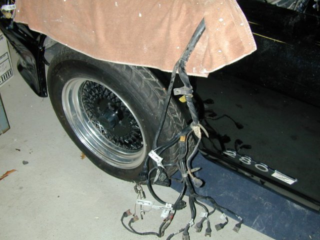

Well I had a good father's day weekend and got the chance to really spend some time on the project. For the past month I have been slowly prepping the donor car by removing parts and tagging all wire connections. I did not cut a single wire and have removed a lot of parts. Yesterday I started at 10:am and dropped the driveshaft, disconnected the brake lines and removed the ABS module. I then jacked up the rear of the car and put a pair of my son's mud truck tires and wheels under the rear wheels of the donor car. I then lowered the front down with no whells on to blocks just low enough to get a couple of dollies under the trans and motor. I then removed the trans mount and the strut bolts and engine cradle bolts. I then used my engine hoist to lift the front body of the car high enough to clear the engine and propped some tree logs and blocks under the car to hold it up. I then pulled the engine and trans on dollies with a come-along wire ratchet. Once clear I hoisted the engine and trans, loaded it onto the back of my truck and drove it to the garage where I put it back on the hoist and sprayed it with degreaser and hosed it down. This took this old geezer a total of 8 hours with no help to do. So those people who say you can drop one of these engine and trans in 4 hours had to have had help and be a lot younger!
