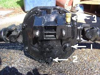

Teekass Posted January 31, 2007 Share Posted January 31, 2007 http://forums.hybridz.org/attachment.php?attachmentid=2249&stc=1&d=1170264517 How do you check/set the rear diff fluid level? The service manual doesn't say....it mentions all the pinion and ring gear patterns, etc. etc. but not the simple question of how to check and set the fluid level. My guess is the level should be right up to the #1 plug.......but I don't want to go on a guess. Also, what fluid do you guys use? Thanks in advance, Chris Quote Link to comment Share on other sites More sharing options...
MrFancypants Posted January 31, 2007 Share Posted January 31, 2007 Yep.. base of the fill hole, basically. Just fill it up until fluid comes out the fill hole and youre done. You can check it by sticking your finger in the hole I used Redline Heavy Shockproof. - Greg - Quote Link to comment Share on other sites More sharing options...
