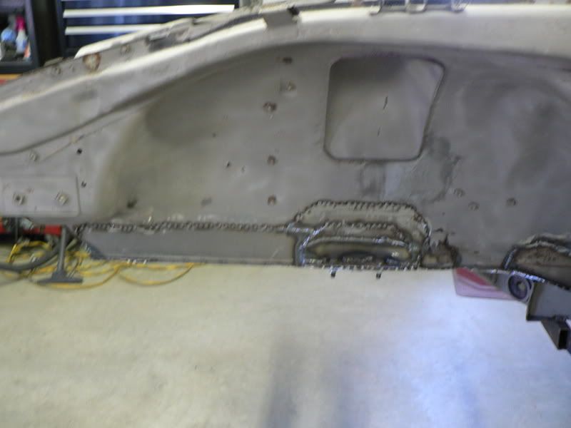

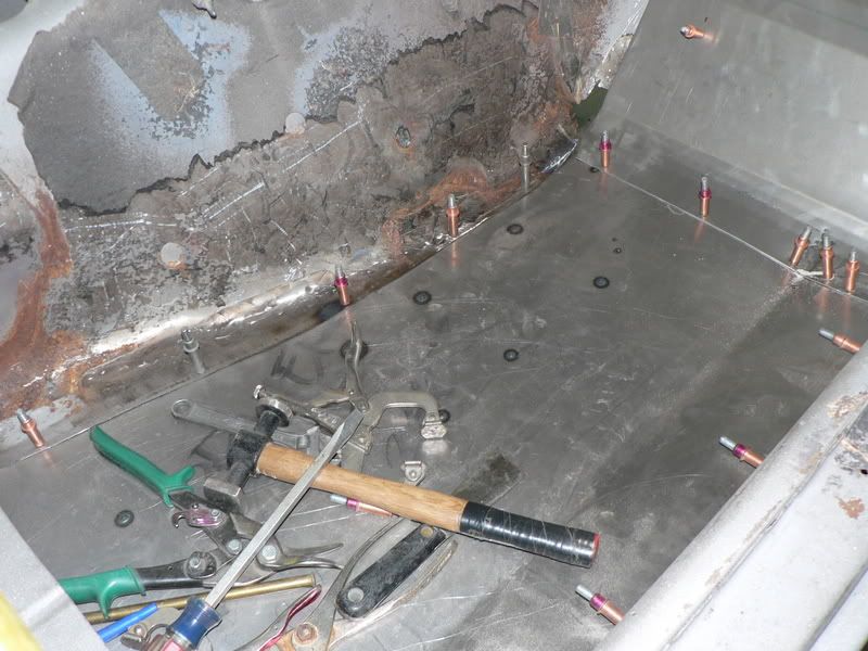

matteo Posted February 16, 2007 Author Share Posted February 16, 2007 Ok. so here're some pics of the work which is being done. also, in the frame rails there are places to bolt on the crossmember. but there were also holes about a food infront of those. i might be ridiculous in asking, but i don't remember what they're for. any help? just curious. also, does anyone know of a place besides MSA who'll sell rear panels that go under the tail lights? After some work by a friend... here come the new floors. the sad thing is... when taking out the old floors, there was less than half as much metal to take out than what is now replaced. a magnet would be able to stick to my car now!! Quote Link to comment Share on other sites More sharing options...
