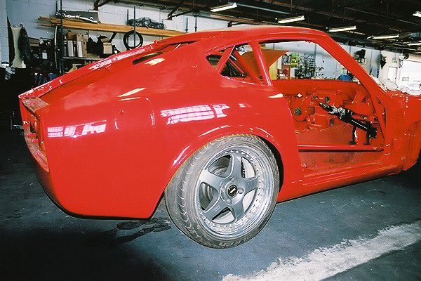

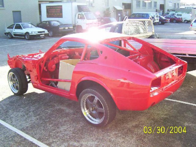

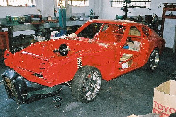

evtech Posted August 4, 2007 Share Posted August 4, 2007 ......... Also running an MX5 (Miata) power steering rack........ . Hi You’ve got my undivided attention, any chance of some piccy's and fitting experiences that you could share with me, I’ve just failed to fit a 280zx unit into my 260, the Wife won’t race it without the ‘comfort’ of PAS, so I’m eager to please if you know what I mean:mrgreen:. Cheers Nigel Quote Link to comment Share on other sites More sharing options...
